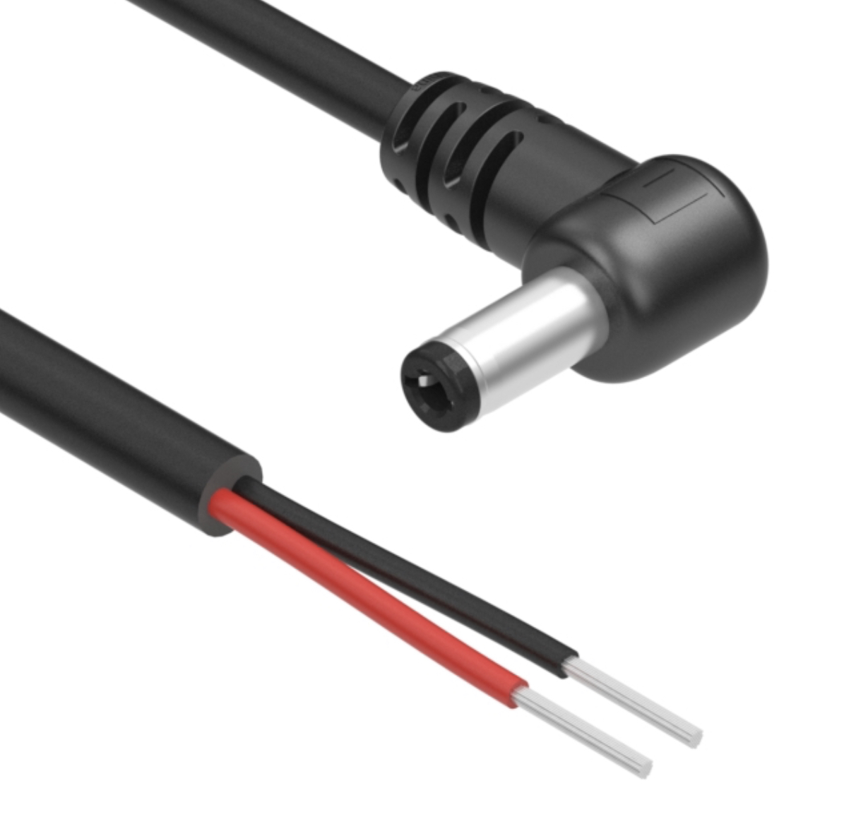

No, but you offered advice that is correct only in a tiny number of cases - hence I corrected it, almost all are simply black with a tracer.
No sir, you are incorrect. These power supplies, in my experience, often have a pair of individual wires inside of an overall round jacket. Some are as you say in a coaxial arrangement, others are as I have described. Get over you need to think you know more than everybody else. I made the point that this arrangement does exist and caution should be used.
I'm not sure what YOUR point is. That because YOU haven't seen it, it's inconceivable and I am lying about it? That YOURS is the only relevant experience and other people's experience counts for nothing?
I've never seen a tracer on a round cable. I also don't think a round cable assembly can be found that doesn't have the red wire connected to center. DigiKey certainly doesn't carry them - they only have these with red connected to center.
Well, I've just looked in my spares archive of wallwarts etc and I have both kinds .. .. .. .. both figure 8 'shotgun' cable with a marking on one core, and double insulated with Red/Black inners. Looking at the ratings the choice may be related to the voltage/current output of the unit, I'm not sure. however ...

It wasnt a psu, I think it was a usb power bank I recently took apart, black was + and red - off the battery.
I think some manufacturers just use the first thing on the shelf when assembling these things.

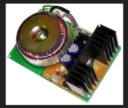

These 'wallwarts' are fine for a small breadboard project or perhaps to some LED lights , but requiring 5v , 5 A It would not be my choice, and controlling motors will require nice 'quiet' logic voltage , most wallwarts are very noisy, switch mode ones are notorious, and the old linear ones tend to let through noise from mains , the bridge rectifier in these can itself be noisy. Better find or build a high quality linear supply using a transformer with an earthed interwinding screen,
with all the suppression caps etc , Found this at ESR Components it is 12v 5 A cost <>50 GBP.
Given that these sort of things are "use until faulty, then throw away" the colour coding of the wires which no one will ever see again after it has been assembled is irrelevant.
With that in mind, whatever cable assembly is on the shelf, or cheaply available from a supplier so saving a few cents, then that is what will be used.
All that really matters is the TS gets a supply big enough to do the job and knows how to test it to make sure he hooks it up right
