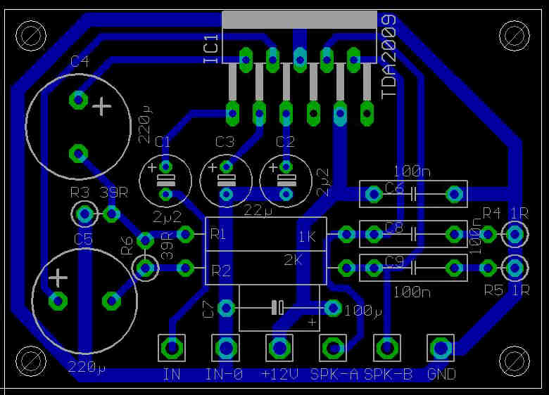

Hi Thunderchild,
I see most of your dilemma is caused by not having a proper PCB-layout for the amplifier.
Here is a suggestion for a quick PCB to make. Use the layout I designed very close to the manufacturer's design (without mixing up OUT A and OUT B, and not connecting unconnected pins of the TDA2009 (pins 7 and 11 are NC, but connected to pin 9 on the layout))
Print the layout normally and tape it to a copper clad. Then poke holes through the paper into the copper surface. Use an EDDING400 (800 for finer traces) and connect the "holes" according to the layout.
Etch and drill the PCB and you'll be finished in no time with a functioning amplifier.
BTW, TDA amplifier ICs are pretty touchy and critical not only concerning PCB-layout, they behave strange if the bypass electrolytic cap is too large in value.
I used a TDA2003 with a 1,000µF bypass cap. The chip's idle current was tremendeously high. After reducing the cap to the recommended 220µF the idle current was OK.
If you are interested in a quick amplifier PM me for the Eagle files.
Regards
Boncuk

Hi Thunderchild,
I'm not quite inderstanding your explanation, do you mean start with a coper sheet and scrape away the excess or do you mean to draw in the neccesary tracks ?
draw the tracks on with a pcb pen or whatever American equivalent you guys have over there (my response is in no way meant to be offensive when I say American...)
I got it..I was thinking of a Sharpie...I think they are water proof arent they?

No, no UV - just draw the tracks on the board, and etch it - you can paint the tracks on if you want, and that was the method used before etch-resist pens.
Yes that's right....
Warm the Ferric solution in a microwave oven if you can...Dont over do it...5-10 secs should do...You dont need much and a small container will save a lot of etchant being needed..just a little more so the board is fully submersed...
Agitate it to assist the process...
Wash thoroughly and clean with some steel wool....drill holes and mount components...

Hi Simon,
the method I described uses a water and etchant proof pen on the absolutely clean copper surface (no grease!)
Print the PCB layout mirrored and punch holes at every pad with the paper taped to the copper clad to avoid slipping. Use the print as reference to draw the connections (traces) between components.
Every part of the PCB not being covered with ink will be etched. The result (after etching) should resemble the traces on the paper. Start from the outer pads and work yourself to the center for better control.
Draw the pads large enough. There is enough space on the PCB. When the board is etched drill holes with the paint still on the copper. After drilling scrub off the paint using Scotch Brite or steel wool. (Edding is really tough.)
