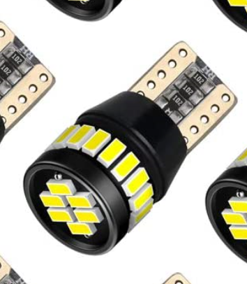

Is this the LED?
or this?
A "Jewel Thief Circuit" can help you get the very last drop of energy out of a battery and run a LED on battery voltages lower than its required rating. This is not a joke. Google it. HTH.

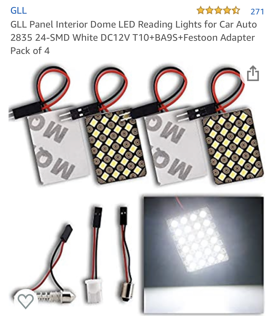

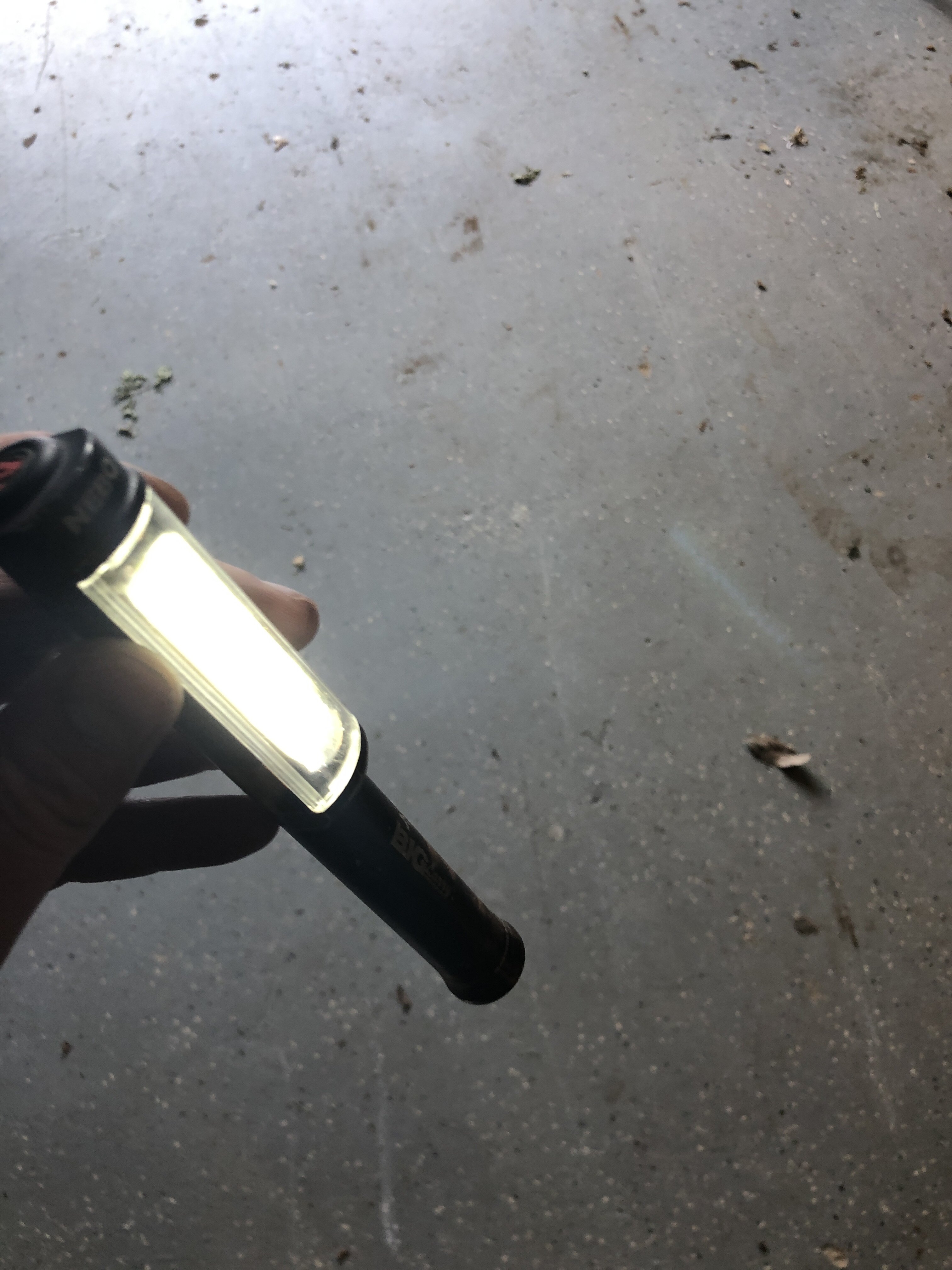

I posted a picture of the LED’s I would like to use.

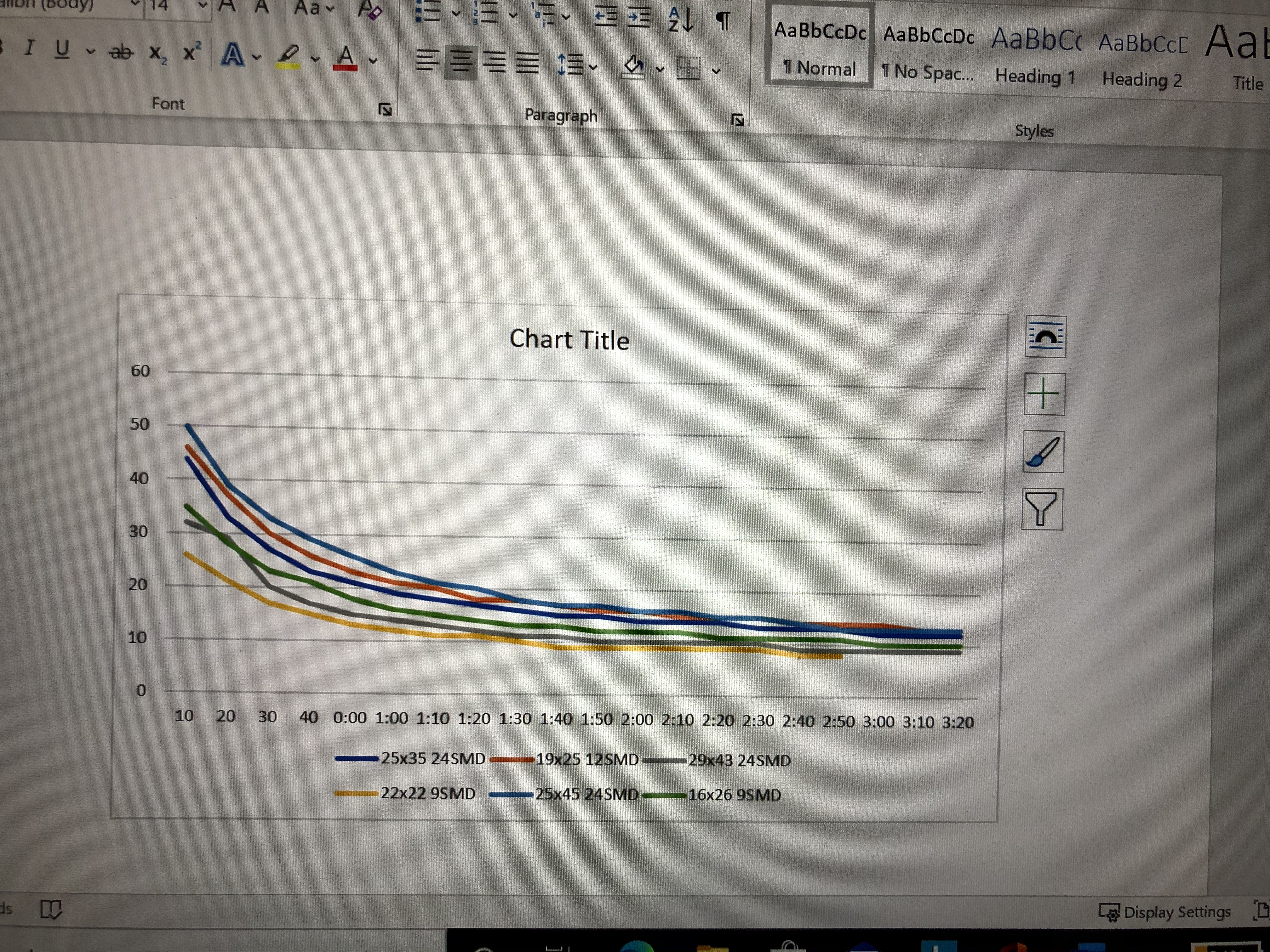

I bought 6 different types that would work. They are all similar to the ones in the picture I posted. They all range from 9 SMD to 24 SMD. I tried to use 4 CR 2032’s but the amount of light fell off so fast. I made a little chart of the different LED’s and how much they dropped off over a few hours.
I will also post a picture of a similar light running off of 3 AA batteries. If they can make this flashlight work, I figure I should be able to make one with 2 AAs that last at least 2-3 hours. I just don’t know what components they use to get the right voltage. Resistors or converters maybe?‍♂️

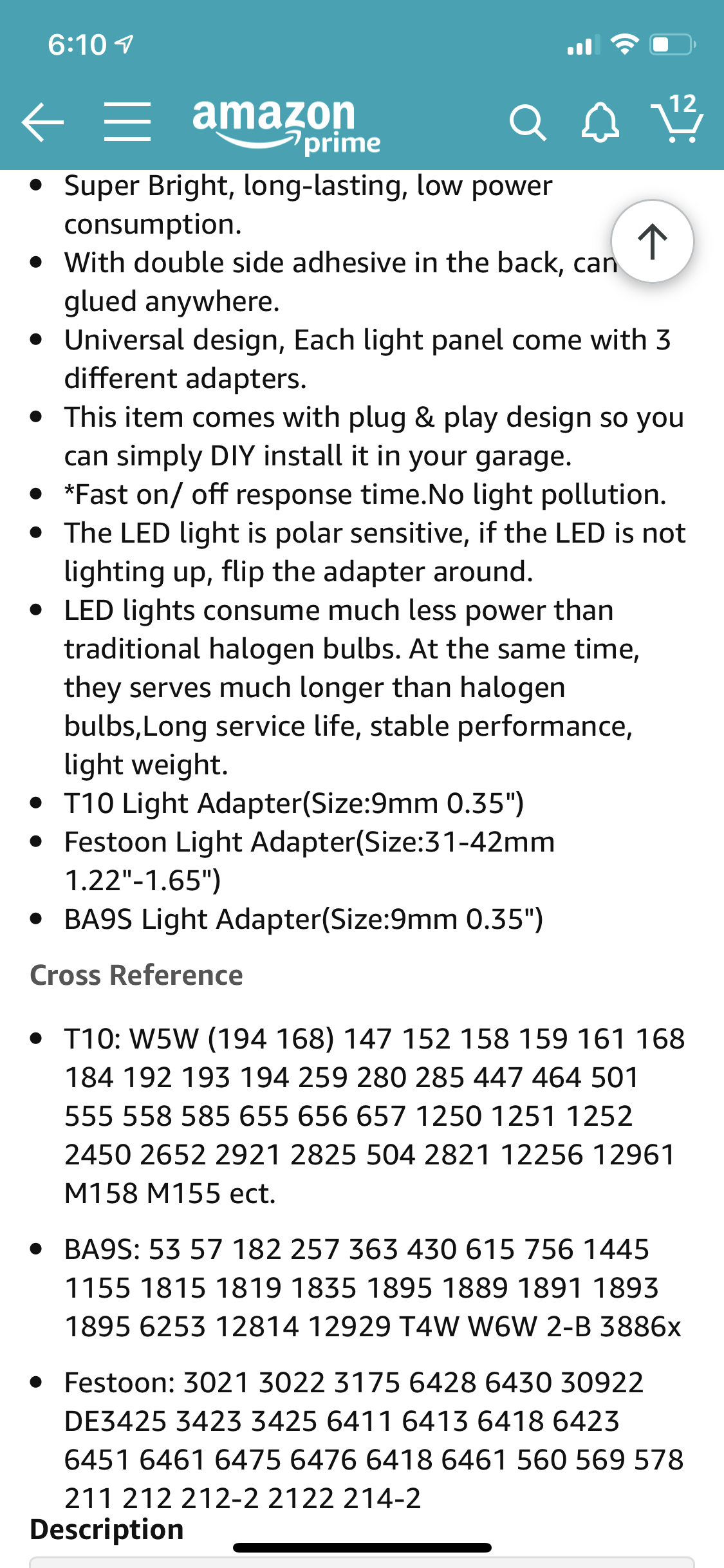

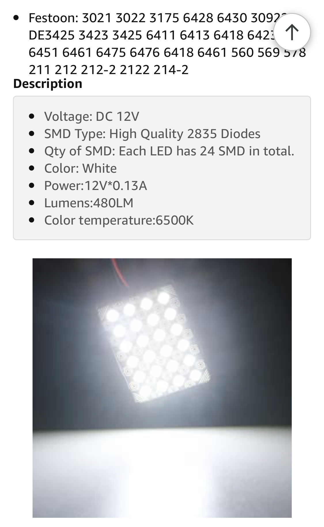

The description says 12V * 0.13A
That is 1.56 W. You might manage to get enough power from an AA battery, according to Mike's figures.
You have to allow for the boost converter losses. It won't be 100% efficient, so you might well need 1.8 - 2 W.
If you find a boost converter that gives out a constant current, instead of a constant voltage, and you set it to 0.13 A, and you short out the resistor on the COB light, the voltage needed will drop to around 9 V and you will need less power. The resistor is there to limit the current if the supply is a constant voltage. It's not needed if the supply is constant current, which is unusual, but power supplies like that are available.
