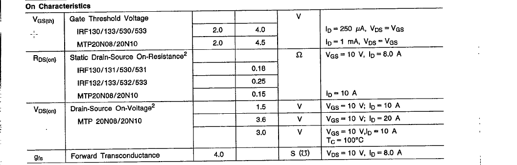

Would that be the gate threshold voltage?
It depends on the current you want it to conduct between D and S. The higher the current, the more voltage you need. Look at the graphs in the datasheet.
Yes, the first row and second column where it says "Gate Threshold Voltage". This is between 2 and 4 volts for a drain current of 250uA and between 2 and 4.5 volts for a drain current of 1mA.
For using it as a switch you need to look at the next two rows where it shows the Rds(on) and Vds(on). As you can see they use a Vgs of 10V for those measurements at higher drain currents. Thus you should use Vgs=10V minimum when it is a switch.
