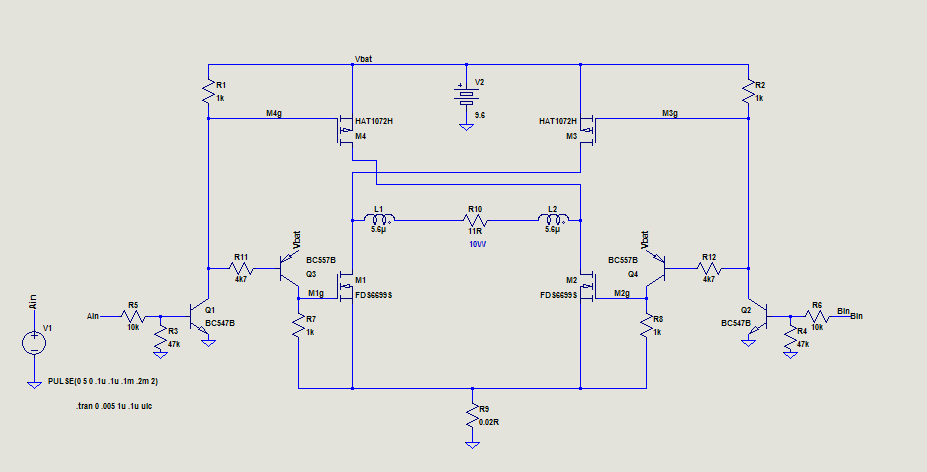

What are the part number of both the P and N channel FETs on the diagram? The datasheet, and knowing the voltage of Vbat, might give us more of a clue.
I know it has been mentioned that the failure points towards a gate-source breakdown, but this circuit could self destruct when it is used. ie: If both PWM inputs are low, nothing happens. If only one PWM input is "high" the motor will run and nothing bad should happen. If both PWM inputs are "high" then all four FETs are turned on and smoke happens!
In the circuit shown, no bulk bypass is shown on Vbatt. If this isn't close enough to the H-bridge or has been altogether forgotten, then Vbatt will be spiking seriously. The P-channel devices will get the worst of it, and will die very quickly.
If Vbatt is 12V or so (gotta guess), and guessing that the motor is less than 6A (R45 is .02 ohms 0.5W) I would use 220µF in parallel with a couple of 1µF ceramics.
[edit] I should mention if Vbatt is an automotive supply, then 14.4V is too close to the breakdown rating of a lot of mosfets and the design needs surgery. I cannot find a listing for a GB3318 or GA3055 mosfet, am I reading them correctly or are these house numbers?[/edit]

can you post some captured waveforms while in test? Show the gate, drain and source of the PFET simultaneously (can be referenced to ground) while switching on and when turning off. If you have 4 channels, show the gate of the lower FET as well.
hi wealth,
Please confirm that this LTspice simulator circuit represents the PCBA.
I know that these are not your FET's I will modify them later.

from the OP's posts: its a test rig that is using the 11R.
2.Use 11ohm 10W resistor replace of the motor,so there is no motor in the testing jig.My understanding is no reverse EM on the PCBA.
I saw it Eric, but he forgot that the inductors he used in series are enough to create the back emf. perhaps the motor is substituted by the combination of these inductors and the 11 ohm.
However 5.6uH is too small to be expected as Motor simulator.
hi Sarma,
As its a R/C toy car, I suspect those 6.5uH inductors are for radio RF suppression.
From the initial tests I have done, it appears that theP MOS fets are failing at power on due to poor circuit design.?
