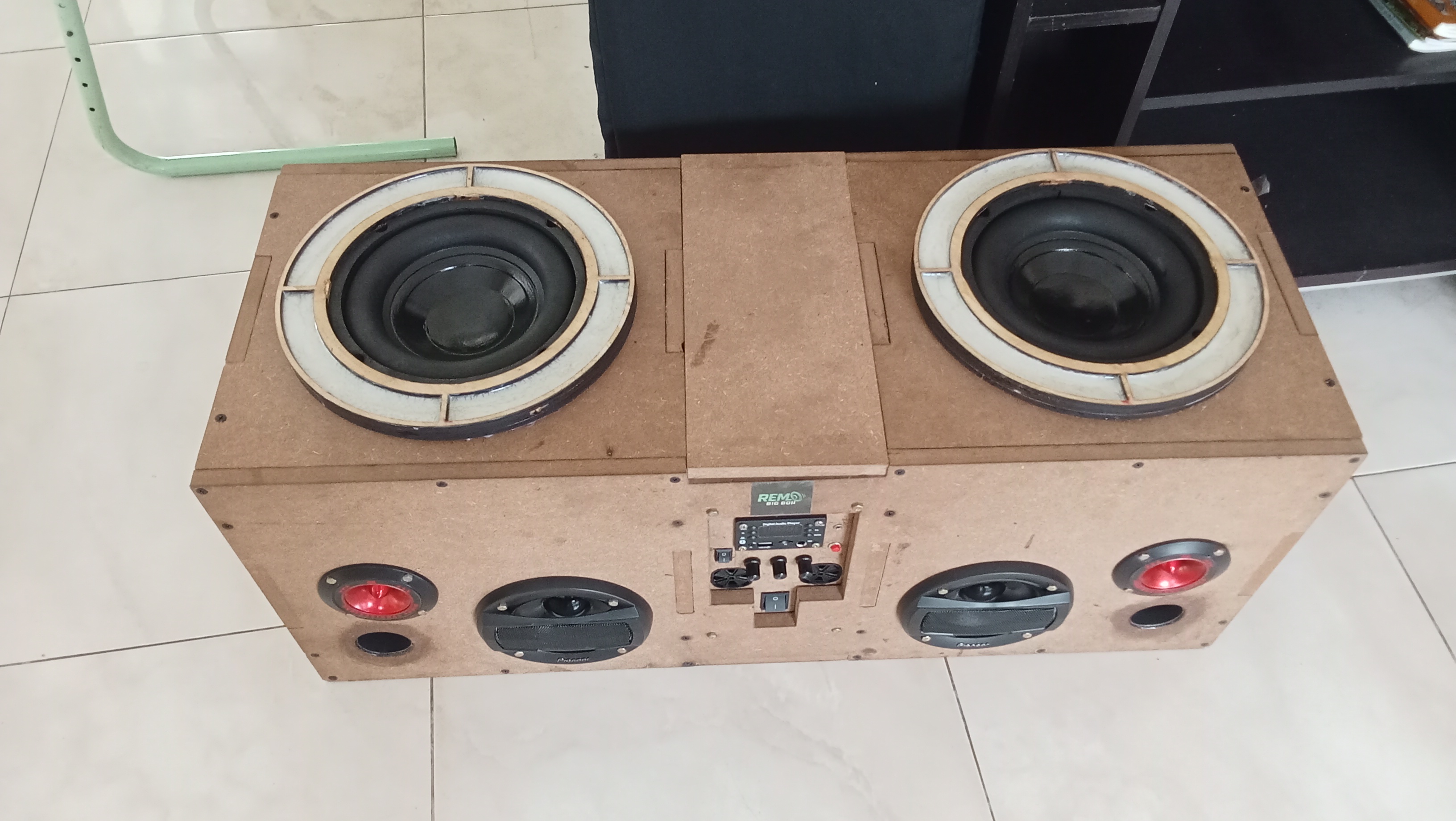

I’ve always been fascinated by electronics, acoustics, and DIY projects. I wanted to build something powerful, serviceable, and uniquely mine—a speaker system that not only sounded great but showed my understanding of design, construction, and repairability.
The Components

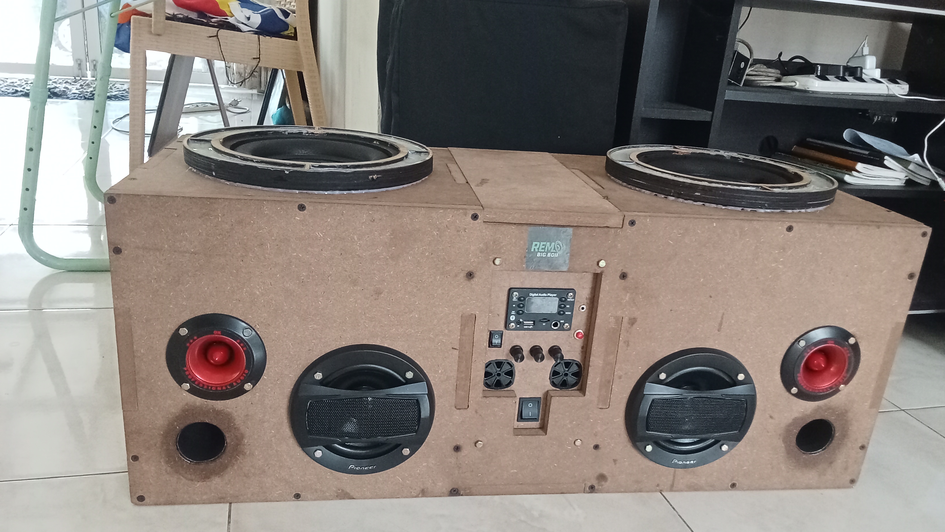

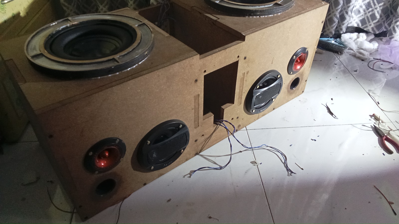

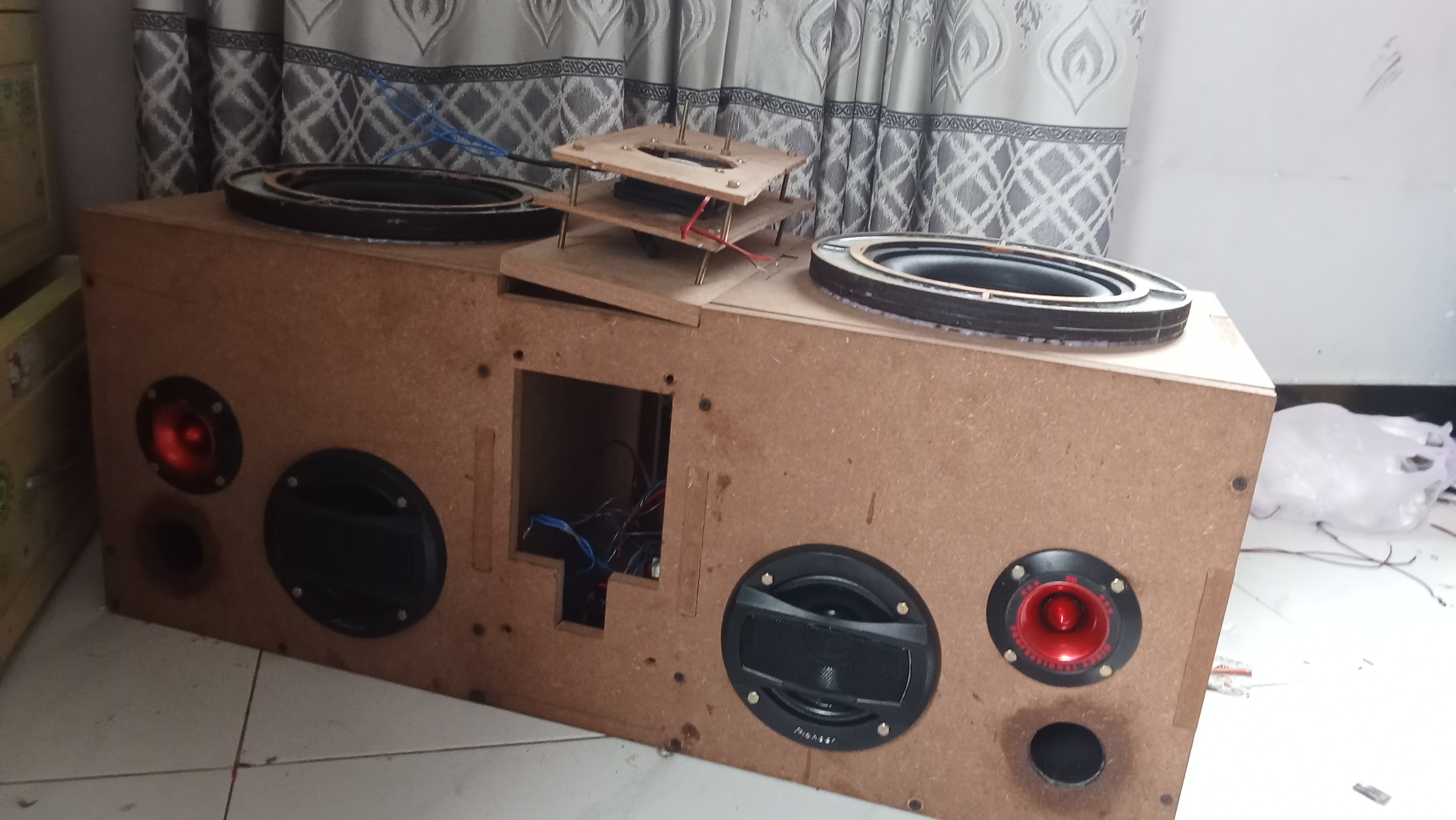

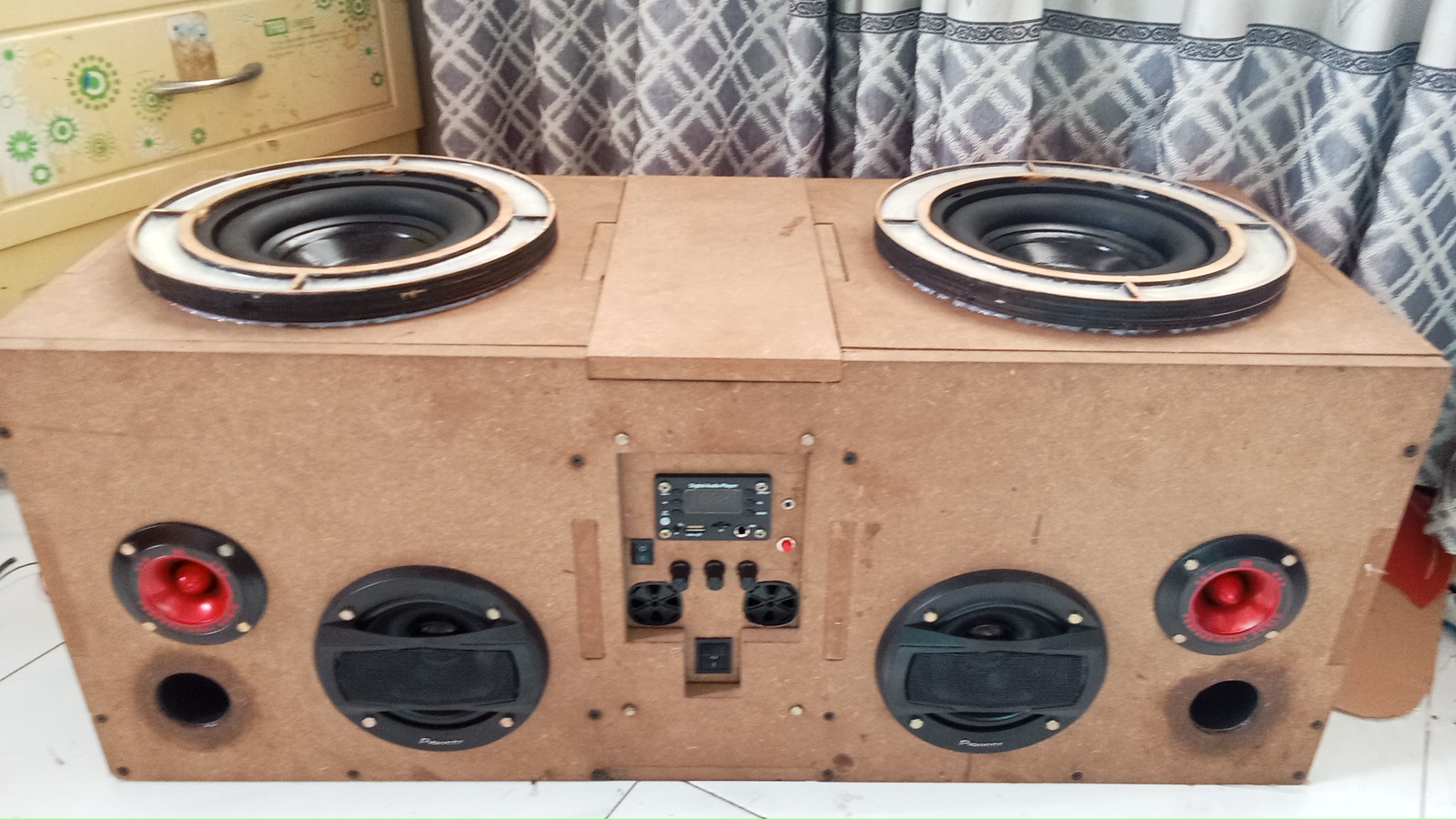

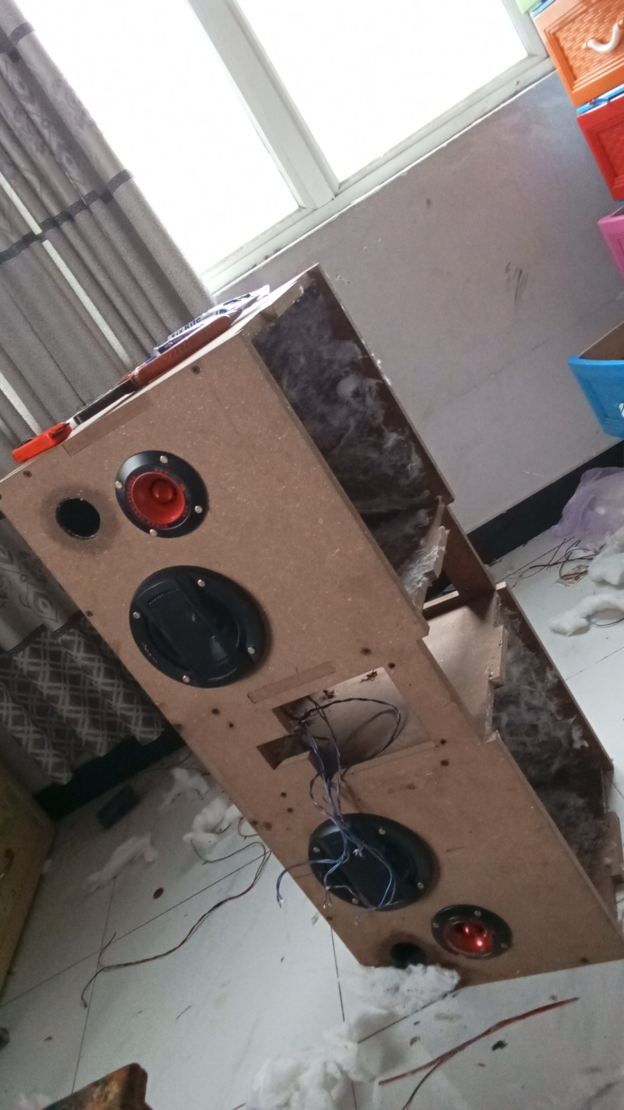

Enclosure:

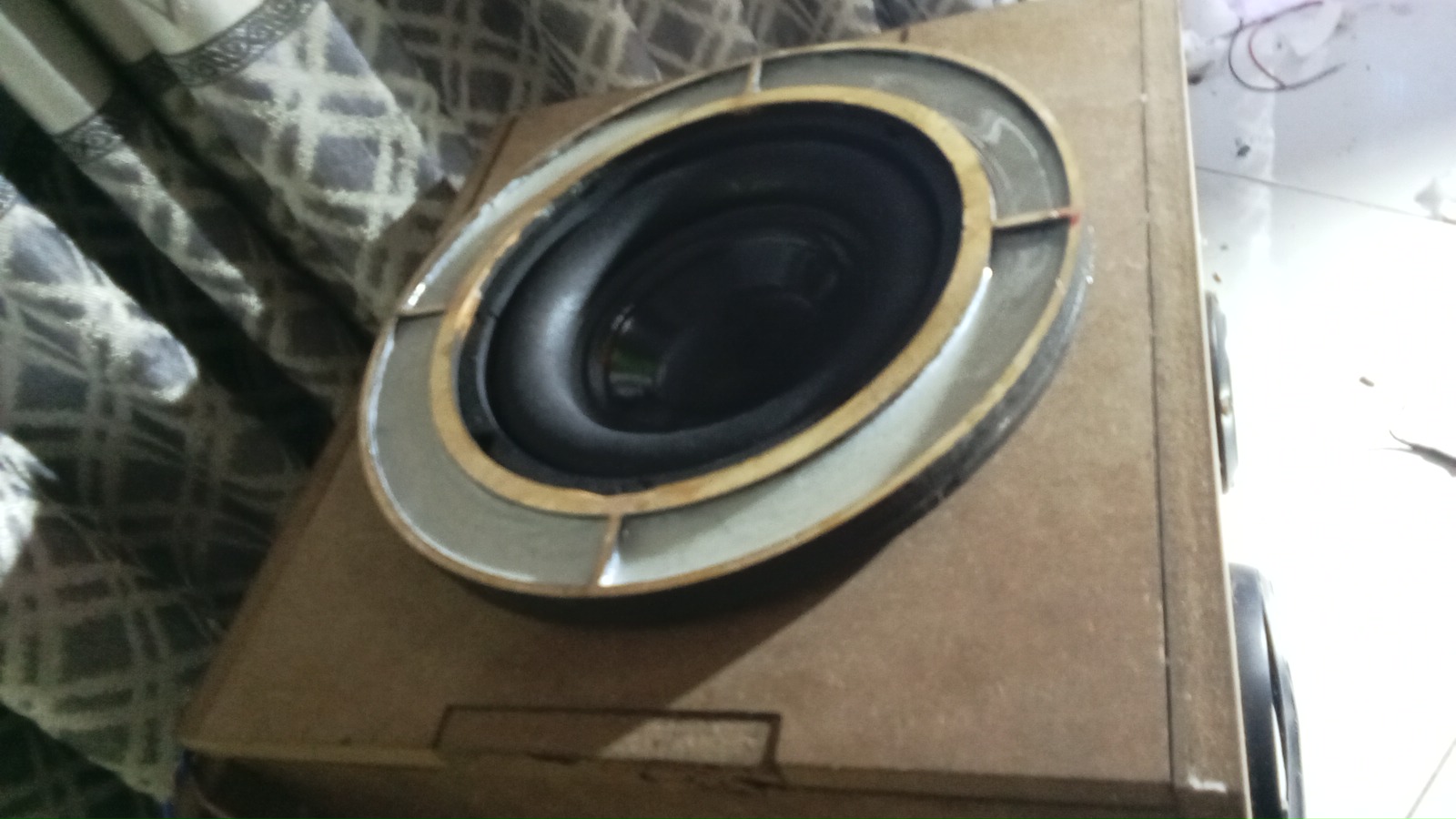

MDF dual-ported box (external dimensions: 34.5 x 34.5 x 34.5 cm)
Internal volume: ~31.2 liters
Tuned to 30Hz for deep bass response

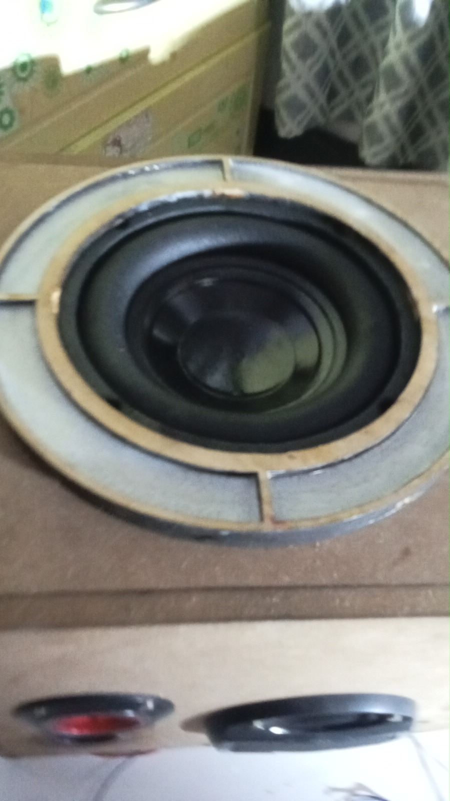

Speakers:
2x Sony Xplod 8" Subwoofers (100W each)
2x 5" Midrange drivers (30W each)
2x Bullet-style Piezo Tweeters (75W each)

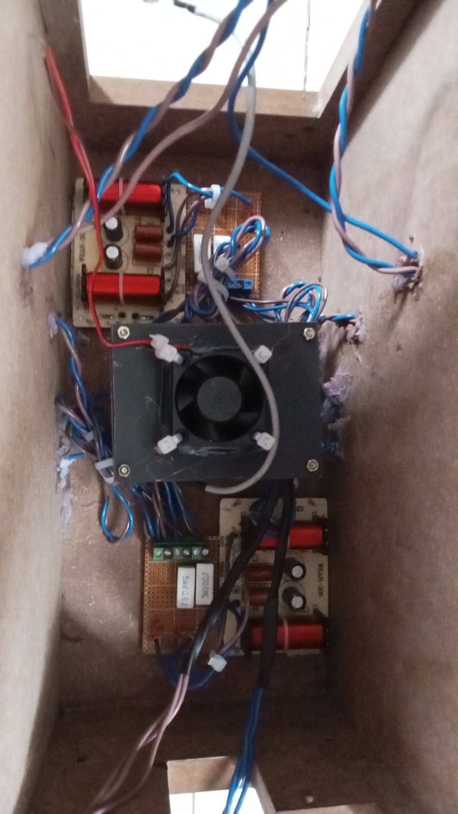

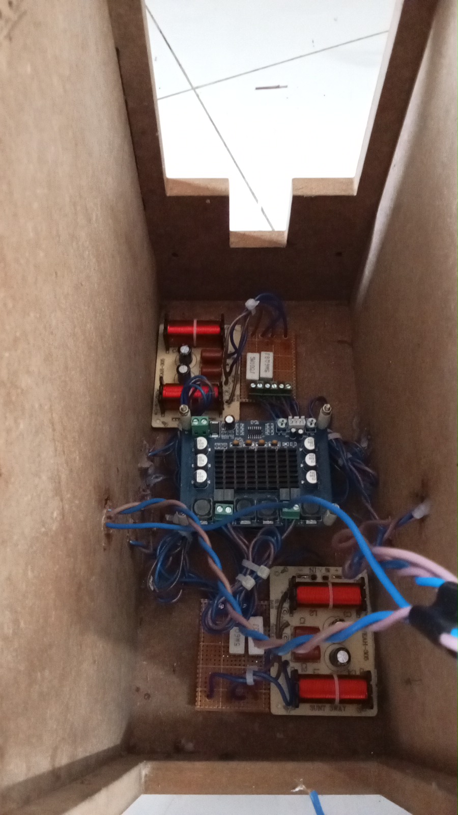

Electronics:

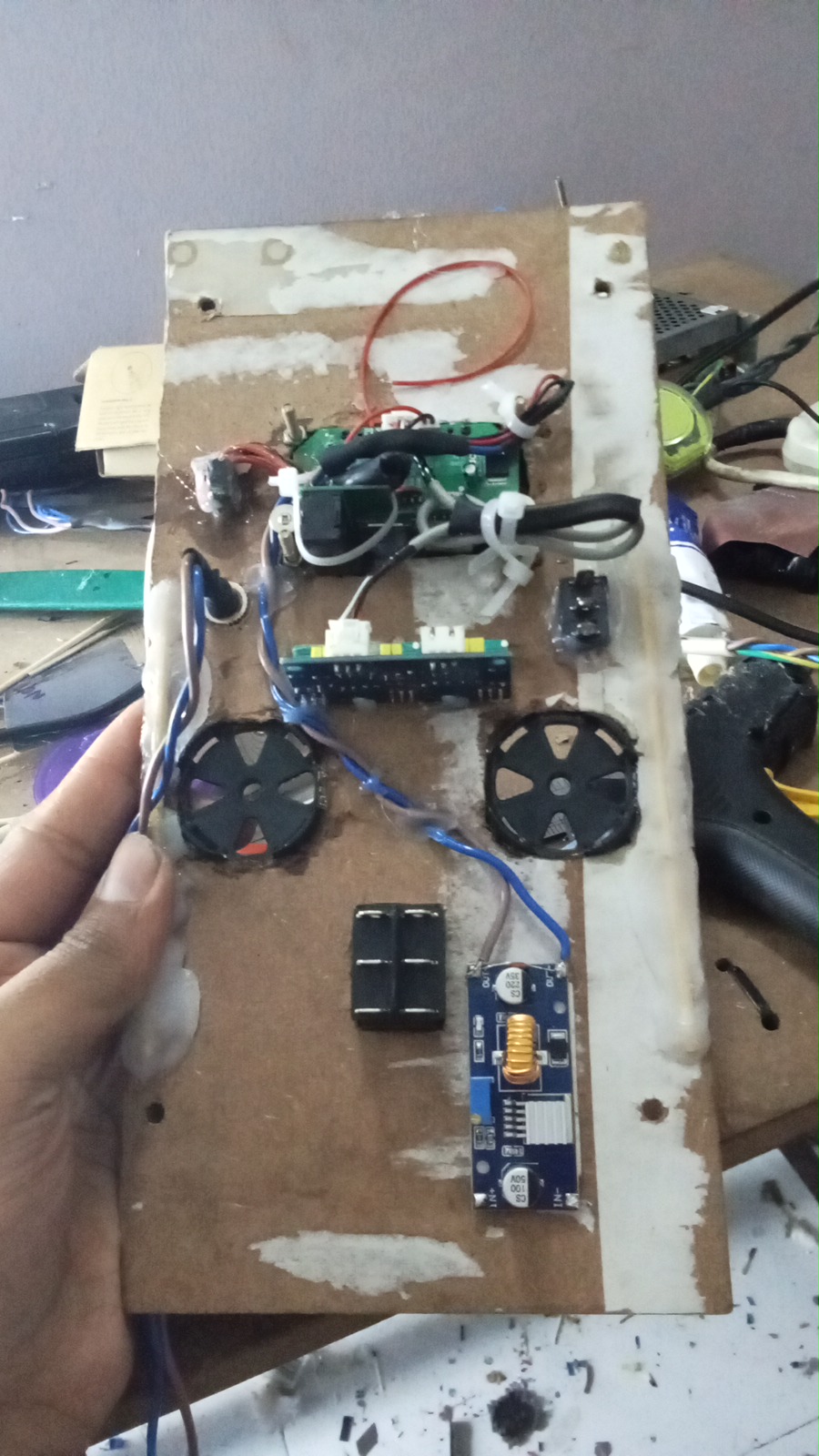

XH-M543 Amplifier Module
Arduino Nano
2x WS2812B LED strips (52 LEDs each)

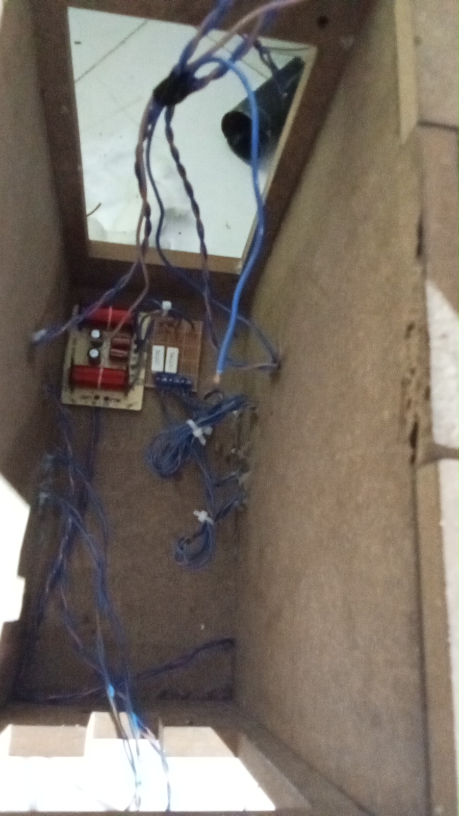

Passive crossover network with high-pass filters
2x XL4015 Buck converters for LEDs
LM7805 regulator for Arduino
12V 10A SMPS with 10x 4700μF capacitors

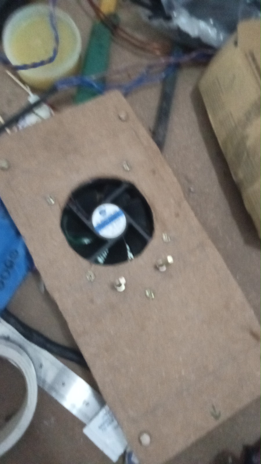

Two 12V fans for cooling (one for amp, one general)
Special Features:

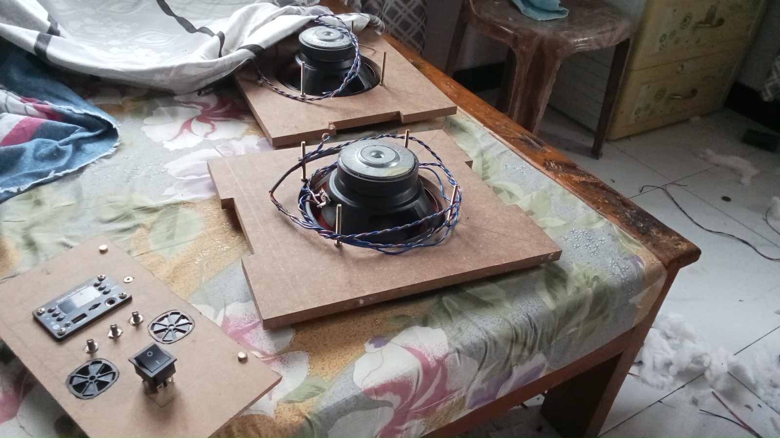

Modular design: All parts soldered as replaceable modules
Upgradeable and serviceable wiring system with tied bolts
Supports input from 12V to 24V DC
Internal full bridge rectifier and capacitor filtering
Building the Beast

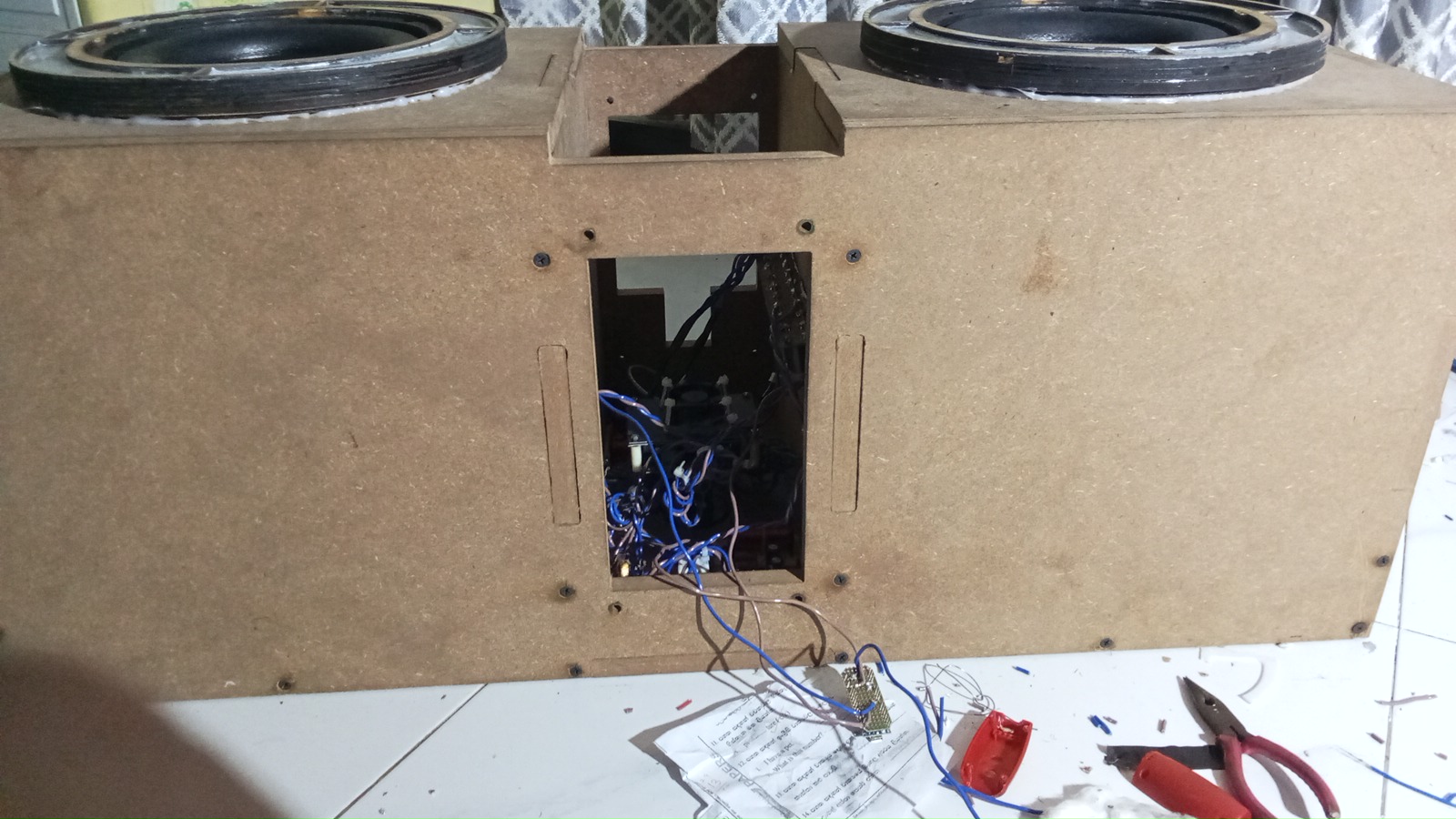

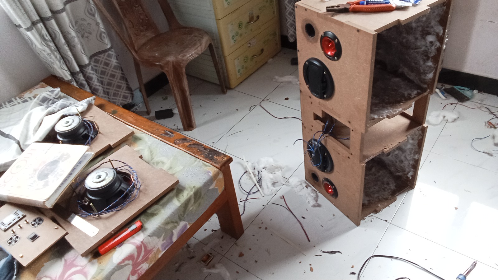

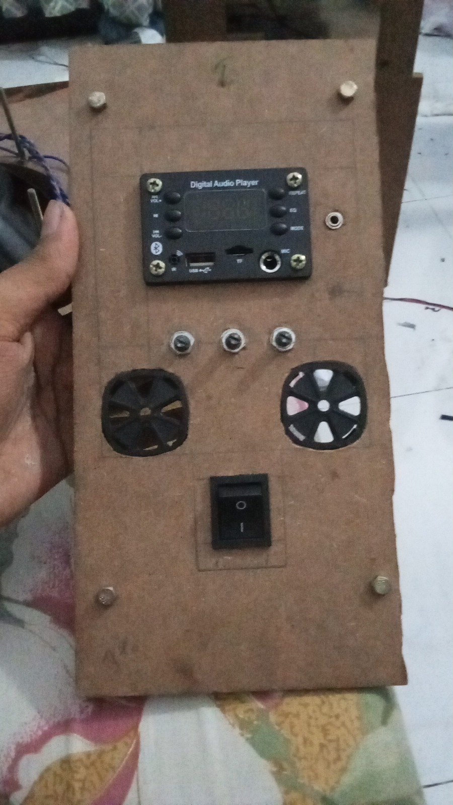

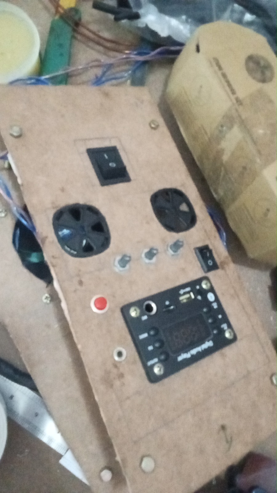

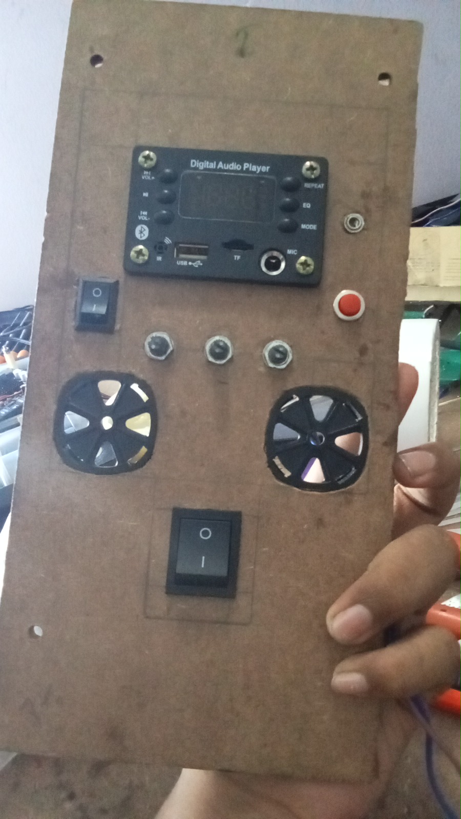

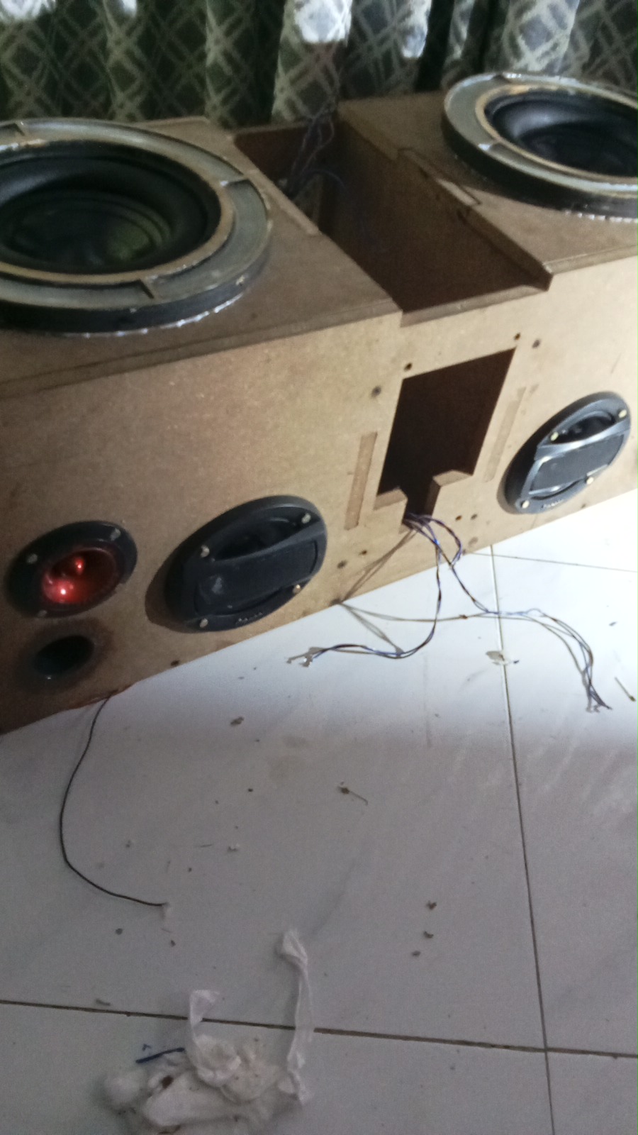

I built the control panel by hand. When my younger brother accidentally broke it, I repaired it with BBQ sticks and epoxy. Every component—speakers, amp, LEDs, filters—was manually mounted, tested, and wired. I used hot glue, custom brackets, and pure determination to keep everything in place.
I stayed up multiple nights, sometimes until 4AM, soldering and programming. I hit budget constraints hard—borrowing money, reusing parts, and making every rupee count (I spent over 50,000 LKR in total). But I never gave up.

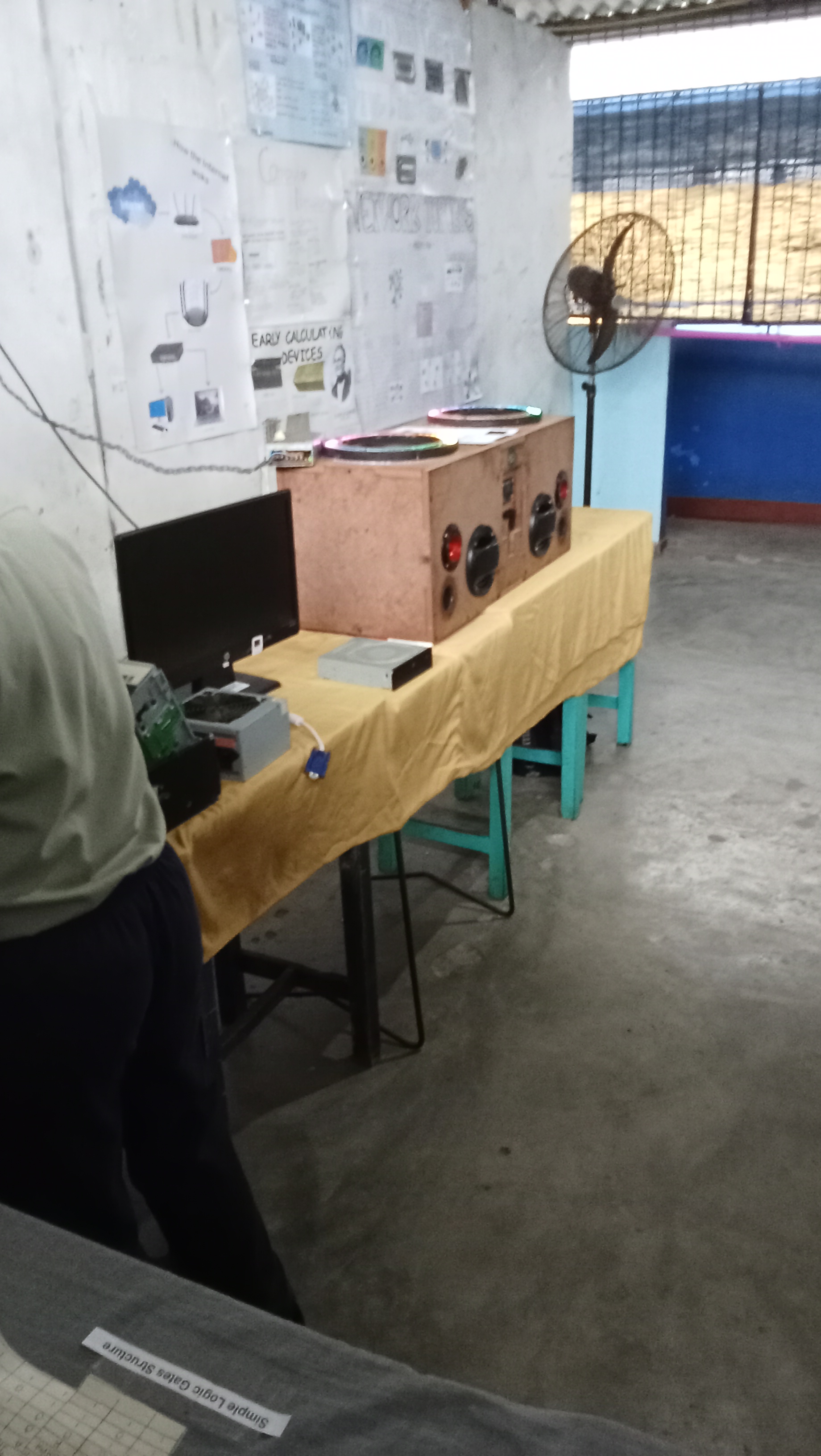

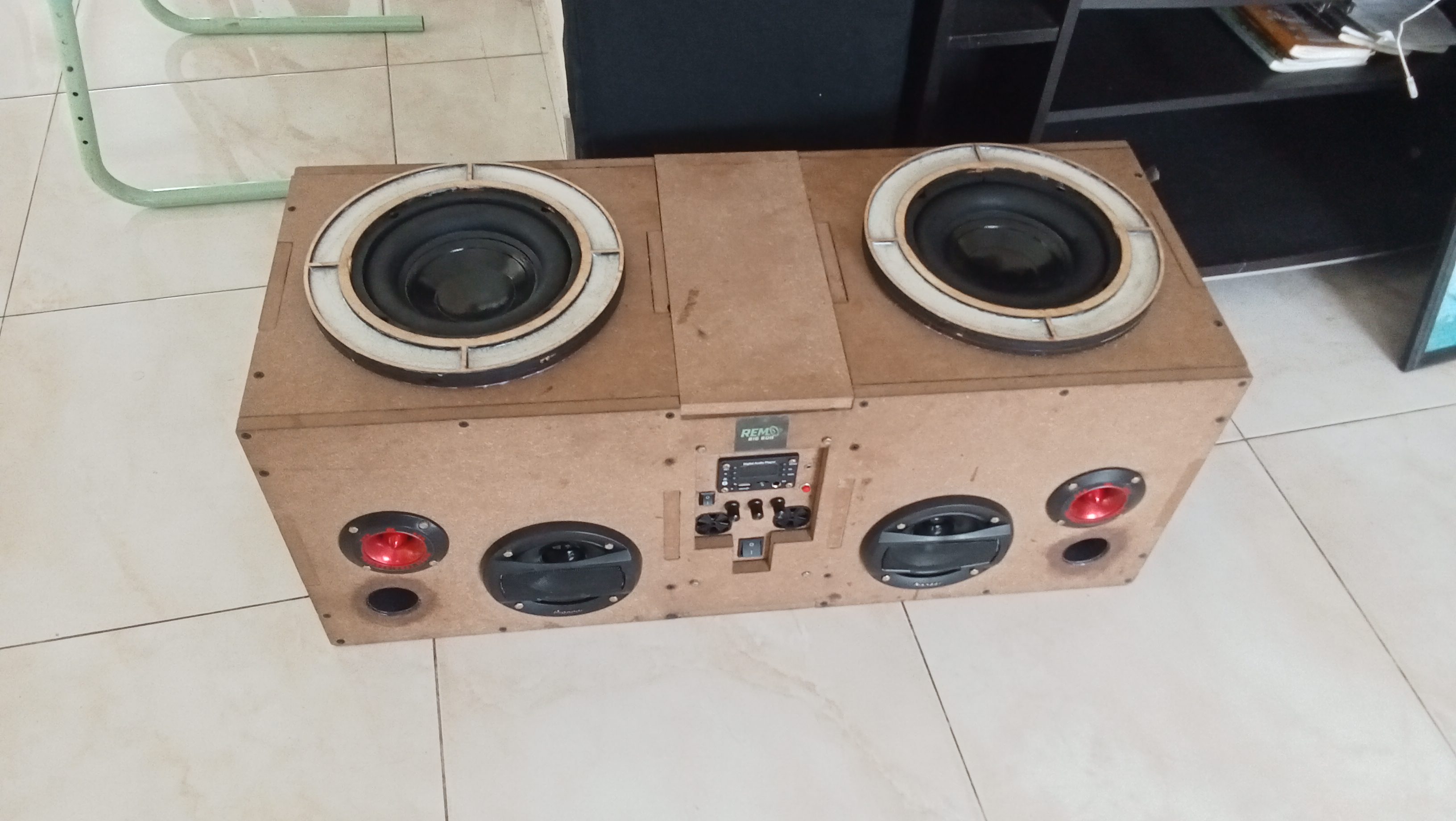

With just hours left, I put the final pieces together. I was nervous, unsure if it would even work. But when I powered it on—the system roared to life. The bass was deep, the LEDs pulsed with animation, and the control panel lit up beautifully.
I nervously explained to the judges:
> "So this is a custom speaker system I made. Some of its parts are recycled, the features are serviceability, upgradability and powering from a battery. It's tuned to 30Hz so it can produce a lot of bass and that's it."
No questions came—but I was ready. And later, I heard rumors that I may have even won 1st place.

I’m not yet proud of the volume—it needed a more powerful amp and 24V input for full output. But for what I had? It was a huge success.
