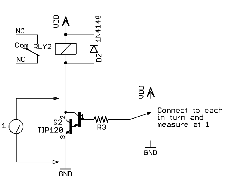

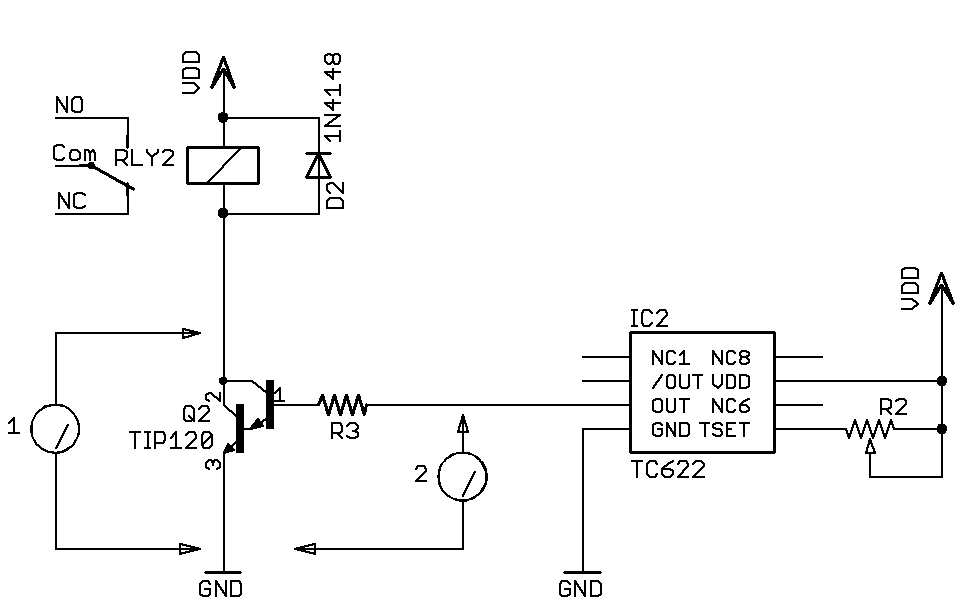

OK, here is the procedure in more graphical form. take the sensor out of the circuit and test the transistor. see the first diagram. Vdd = +12V. use a dmm and measure across the the transistor. with R3 going to gnd, the DMM should read somewhat less than 12V. if it's zero, you've got a wiring problem - make sure there is power to the circuit and the relay is really connected. Then connect R3 to Vdd (+12V). the relay should pull in ("click!") and the dmm should read a bit less than 2V.
You can do the same with the mosfet circuit though I would add a gate resistor just to be safe. 20K should be fine. but, again, debug one at a time.
If that works, then add the tc622 back into the circuit. see the second diagram. measure at point 2 in the diagram and you should see around 10V when the sensor is below the setpoint temperature. note, you should see the opposite on /OUT. so if OUT is 0, /OUT should be about 10V.

you posted while I was doing the same. to answer your question, the transistor is an current amplifier. the darlington has a DC gain (Hfe) of 1000. so you .6 mA (actually more like .5) coming out of the tc622 will get multiplied by 1000 or .6A. Of course, the coil resistance limits this to the 75 mA.
the mostfet acts a bit differently - think of it as a variable resistor. super high resistance when 0 is at the gate, super low (.4 ohm) when +10V is at the gate. in both cases, you get enough current to cause the relay to pull in.
