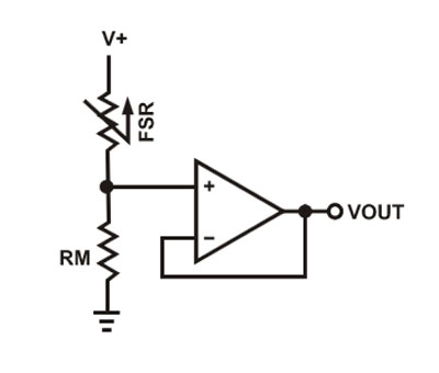

Hello everyone. I'm planning a project which involves using a force sensing resistor (FSR) to convert force to voltage, but I'm confused as to some details (I'm a total newb, so bear with me). I'm considering using the Interlink FSR 408, and I found a useful integration guide for it. On pages 18 and 19 of the guide, there are schematics for a voltage divider and two types of adjustable buffer. I have some questions about these:
1) Based off of the schematics, these circuits require: FSR, opamp(s), resistor(s), potentiometer(s), and... what else? A 9V battery? Anything else?
2) According to the guide, one difference between the voltage divider and the adjustable buffers is that the adjustable buffers allow adjustment of the gain. In this case, what is 'gain'? Is it simply referring to a further increase of the output voltage, perhaps a multiplier of the applied force?
3) The adjustable buffers also allow adjustment of 'output offset.' What is this? The guide states that "offsets resulting from the non-infinite FSR resistance at zero force (or bias currents) can be trimmed out with a potentiometer." Is this a long-winded version of saying that I can use a pot to eliminate extreme voltage outputs that happen when I'm not applying any force to the sensor? Or perhaps it has to do with a attaining a better force-to-voltage curve by eliminating the response of the sensor when no force is applied?
Any help would be greatly appreciated!
You would want a meter to measure voltage out. Use of a 9V battery for power may or may not be what you need as that will depend on the OP amp you are using. For understanding, those three graphs are basically assuming V+= 5V and GND = 0V. Since the OP amp is not given, let's assume that you chose an MCP601 and V+=5V and GND=0V. Again, many different OP amps could be used.
Stick with the first circuit initially. Once you understand that circuit, you will be able to understand the other two.

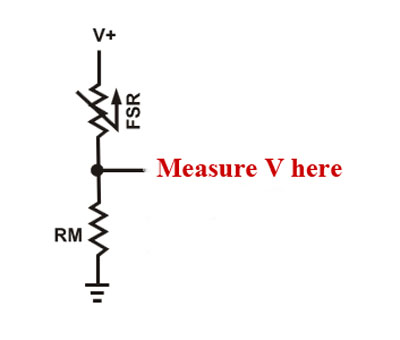

Look at this portion of that circuit:
That is a simple voltage divider using two resistors; the top resistor is the FSR (which is a variable resistance, in Ohns, depending upon the force applied) and the bottom resistor is a fixed resistor of some value (in Ohms). Look here for a decent tutorial.
When you add the op amp, you are buffering the voltage out.

At this point, some recommendation for an introduction to OP amps is probably called for. Look online for a simple one. Many times you will see these circuits used with V+ and V- (e.g., +9V and -9V) rather than V+ and GND (e.g., +5V and 0V). That might confuse you at first. I suggest that, at least initially, use an OP amp with V+ and GND (there are ones [like the MCP601] specifically for that, called single supply op amps - although EE's can take the mystery out of the +/- aspects).
Looking at the graph for the voltage out for the circuit, you can see that it depends on the value of the fixed resistor (RM) and the resistance of the FSR.
You should be able to see that so well that given the value of RM and the voltage out, you should be able to calculate the force applied to the FSR.
Now, you have to reveal what you want to do with it because it is going to determine how you use it and whether you use circuit 2 or 3 or something else.

Thanks very much for your response. I read up on some things, including what you suggested. Regarding what I'm using this for, I want to use it as a pressure sensor on a guitar which uses the output voltage to interact with effect unit that accept 0 to +5V CV. I'm thinking I don't even need to bother with Arduino in this case, right? I more or less get the circuit now, so I plan on buying the sensor, the LM358 opamp as per the guide (or maybe there's another you recommend?), some pots/resistors, and some breadboard, and then start testing things out.
So to simply the adjustable buffer circuit, it's basically a voltage divider using a resistor chosen to get the voltage output in the right ballpark, then there's a potentiometer to fine tune the gain, i.e. fine tune how much force is needed to get the desired output. Is that correct? The schematic in the link you sent me also has a hysteresis resistor, but it doesn't seem I need this because this isn't a toggle on/off situation.
The only thing left that I don't understand is the second potentiometer in the guide I linked, which is used to trim output offsets. I don't see this in the link you sent, unless it's functioning similarly to the hysteresis resistor. Is it the same thing? And whatever this thing is, why would I want to isolate it from the gain pot, as in the 3rd schematic from the link I sent?

Glad you are getting in to it some more. I think that if you get some parts and start to see how they act, you will get a feel for the circuits and the characteristics. I recommended the MCP601 OP Amp and +5V and 0. The LM358 is a little bit different, but you can experiment with that as well.
No, hysteresis is different than the third circuit. The link I posted was to give you an example, but as I said, its use was as a simple switch with an adjustable threshold. You should be able to build all three circuits and see how they are working.
