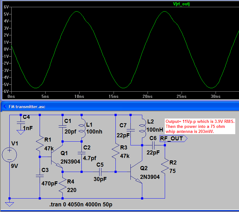

My FM transmitter simulates and works well. A quarter-wave whip antenna is 80cm long and is 75 ohms.
My output amplifier is tuned and has a nice big output level:
Thanks very much for your reply sir and schematic too.
What are the possible faults in this circuit?
Sir for your circuit,could you plot waveforms at oscillator output and rf out on same plot?
And how to calculate power delivered to antenna?
And as I told in my previous post,when I whisper the audio is clear,but as I speak normal,the audio distorts a lot.
Anything you would recommend regarding resistor in series with mic in this aspect and the coupling cap to next stage?
In my FM transmitter, if the output stage, an oscilloscope or an antenna is connected to the collector of the oscillator then the oscillator stops oscillating.
The maximum sound level heard on an FM radio from an FM station and from this FM transmitter must be the same.
If this transmitter tries to go louder then maybe the radio overloads and causes the distortion.
It is normal for the received signal to be extremely distorted when you speak loudly or closely to the microphone because the audio preamp transistor has lots of gain and is designed to pickup faint far away sounds. Many of these simple FM transmitters do not have the preamp transistor then you can talk closely to the microphone.
Colin uses 39k to power the Jfet transistor inside the electret mic then its current is too low and causes distortion. Try 4.7k ohms instead when the supply is 5V.
Finally tried out the schematic by audioguru Sir.Now I am using a 6V(1.5V x 4) battery to power my transmitter.Apart from that added the tuned amplifier at the output and replaced the 15cm antenna by 1m long copper wire.I added inductor and variable cap at the tuning o/p stage to the same pcb and removed the fm freq adjustment cap(as I found that the variation was very less and mosty variation was happening by inductor turns spacing)The range increased drastically. now the range is around 30-50 feet(that is after tuning the output amplifier).But still the audio output is a bit distorted.thnx all..I am sharing a few pics of my transmitter.:p..Thnx to all..
Don't you think that the sensitivity of the FM radio and the length and direction of the antennas affect the range?
The antennas must be about 80cm long and be parallel.
My FM transmitter has a range of over 2km across a large river valley with nothing in between to my very sensitive home stereo FM tuner and my very sensitive FM car radio. But its range is barely across the street to a cheap clock radio.
