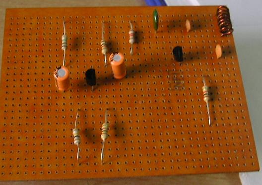

Try making it with very short wiring. Another guy reported that his didn't work. It looked like this:
