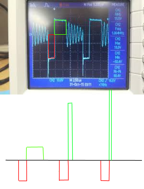

Flyback with transformer:
When the transistor is on, current flows from supply through the primary of T1 to ground. (no current in the diode....yet)
Energy is stored in T1.
When the transistor opens up the collector voltage jumps up above the supply.
You can put AC across a transformer (inductor) but you can not put DC across the transformer. The average voltage must be 0 volts. When the transistor was on, if you put (12 volts for 10uS) on the primary then when the transistor is off it will fly back above the supply for 120VuS. (12Vx10uS or 24Vx5uS or 120V for 1uS ...)
The secondary voltage will also flyback (upward) until it runs into the voltage on C.
The power stored in T1 will be moved to C. This charges up C. Rl discharges C a little.
If Rl is removed the voltage on C will increase each cycle, with no limit. (assuming there is no feedback to cause the dutycycle to reduce)
The red square is power into the transformer. The green squares is power going out. The red and green area must be equal. (volt time)
Unlike most type of power supplies, a flyback (under some conditions) will try to make infinite volts.
Understanding volt seconds is a critical part of magnetics.
