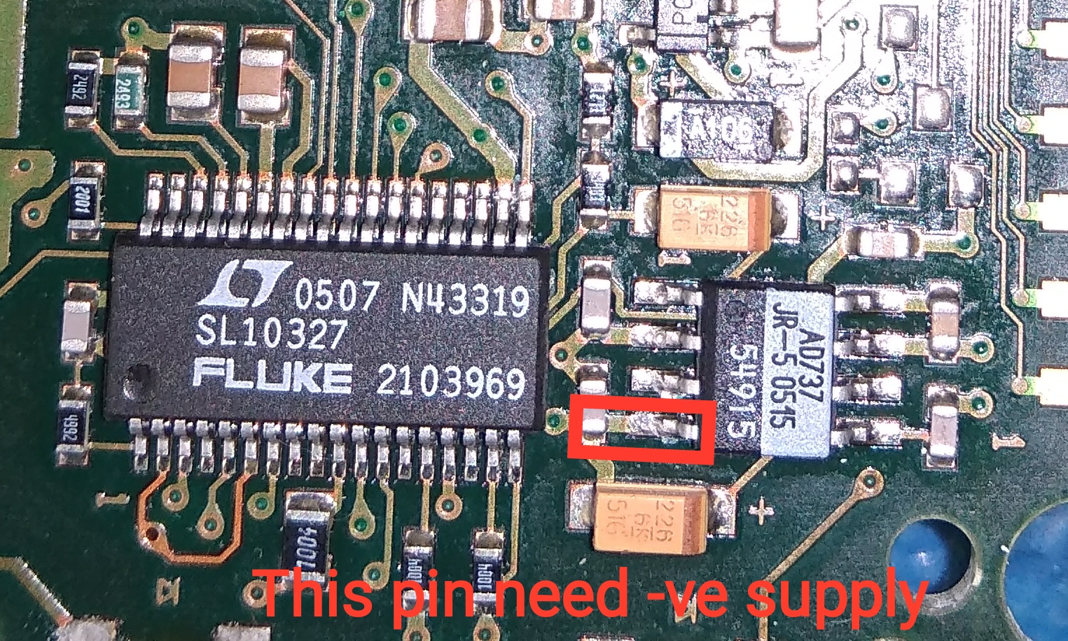

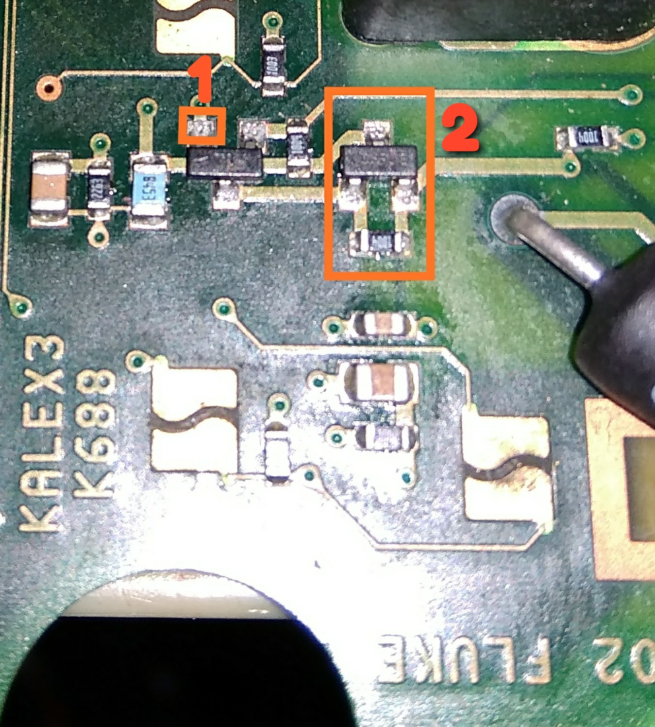

My Fluke177 is not working suddenly..... Its not show nothing in display....Battery is a new one with the voltage of 8.7 v. No corroded track in PCB. There is an IC AD737 is in PCB and it need a negative supply. But all positive voltage and regulator IC's are giving correct voltage. The negative voltage is missing, I think. Please check the uploaded image. There are two marking and I have question about this point....
1. What is the voltage in this point with respect to ground?
2. Which component is this?
I think its a voltage conveter stage and produce the negative supply.... the marking is "C5P5E" on this component. No datasheet available.....

The 4th pin of the AD737 need negative voltage....
Track not corroded and its connected the above point 1.

The only references I can find to a component starting C5 are either a PNP transistor or a dual schottky diode..
I don't see enough components in that board area alone (the original photo) to create a charge pump.
It would need either two transistors and capacitors or one plus inductors, then plus a rectifier either way.
(plus resistors etc.)
What do the other heavy tracks connect to? The vias left of 1 and right of 2 in your photo?

Finally I figerout that the controller M430F437 are faulty...Clean the pad of disply and selector switch throughly...No chane.
I allready change the LT10327, LT1070...
But no progress...
I am trying to findout the firmware for this model.....If it get, the controller available at ebay store...
If not success, I really dont know what i do next.....
