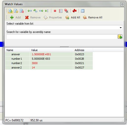

Not experienced on float, just tried this:
float           number1;
unsigned int    number2;
float           answer;
int             answer2;
void main()
     number1 = 0.005;
     number2 = 1000;
     do
       answer  = number1 * number2;
       answer2 = answer ;
       number2 = number2 + 1000;
 while (1);
.. and I get a wrong answer value in answer2 variable. It's always 1 less.
So, maybe it sees say'3' as 2.999999999 etc.etc ??
I can get around it by always adding '1' but that does seem rather inelegant. So, where am I wrong ??

Float to int is ALWAYS the floor value ie 2.3 = 2... 2.9 = 2 2.000001 = 2 and 2.99999999999 = 2.
You may want tio use the function ceil()... But I don't know if you have it in mikroC... ceil() returns the number rounded up... floor() returns a number rounded down.
Or you can use round() if it has it, but the standard way is to add 0.5 before the implicit floor() conversion. This way 2.0000001 to 2.499999 will still give you 2, but 2.5 to 2.9999 to 3.49 will give you 3.
ETA: obviously doesn´t work for negative numbers, you need to substract 0.5 there.

No round() in MikroC it seems.
The advise from Ian works fine ..

Yes but for 2.0001 ceil will give you 3 which is obviously not correct. If you add the 0.5 or -0.5 for negative numbers first you will get a properly rounded result just with the implicit floor conversion.

Yes, indeed I found that your advise was correct.
