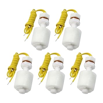

The scale of this project is quite small, so my float switches look more like the below picture.
The container i am filling will only be about 1L, and is located inside a waterproof compartment. I need to cut the power once this container is full so it doesn't overflow. The other float switch (N/O) is located outside the compartment on the ground. When rainfall causes the water level to rise, it is triggered and begins to fill the container using the cycle of 5 seconds on, 600 seconds off. Once the container is full, I need the power to be cut so that the bottle does not overflow.

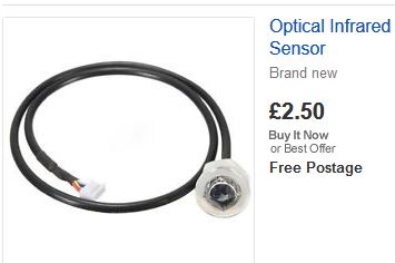

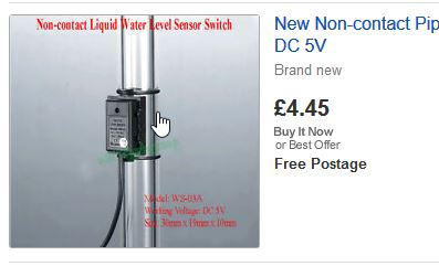

My approach would be to use a cheap Arduino Nano clone board , around £3 and just use some simple coding to produce the actions you need, driving the motor with a simple transistor and/or relay.
That would also use a lot less current than the module you show, so meaning longer battery life.
Also if using something like the Arduino means you can also readily use some of the more modern fluid level devices like these two below, which having no moving parts so possibly more reliable .
The optical one is accurate to about 1.5mm and the stick-on external one is about 3-4mm. ( using them myself).
