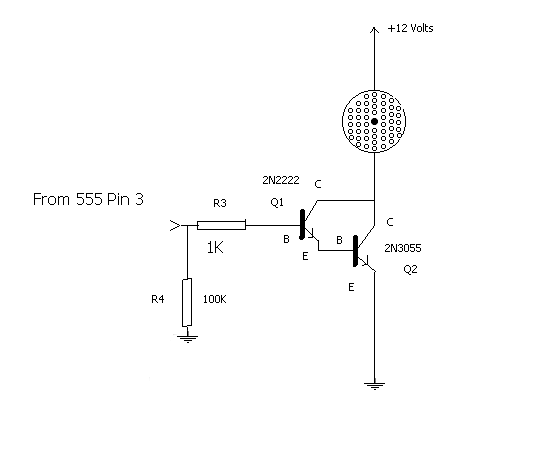

I found this schematic for powering an LED array from 12V using a 555 to make it flash. I am wondering how exactly it works. Like, what are the transistors there for? I still don't quite get how they help power things. Or how they amplify. Are they being used as an amplifier in that schematic? Or are they serving some other purpose? Any help understanding that schematic would be GREATLY appreciated.
Forgot to post the image. Here it is:
It is a stupid circuit because it has nothing to limit the current so the LEDs will blow up.
The transistors amplify the current:
1) The current from the 555 into the base of the 2N2222 transistor is limited by the 1k resistor to about 5mA.
2) With a 5mA base current then the emitter current of the 2N2222 transistor is about 600mA.
3) With a 600mA base current then the collector current of the 2N3055 transistor is about 8A.

"With a 600mA base current then the collector current of the 2N3055 transistor is about 8A."
This is not true.
The current into the base of the 2N3055 is limited to the current taken by the load in the circuit under investigation.
