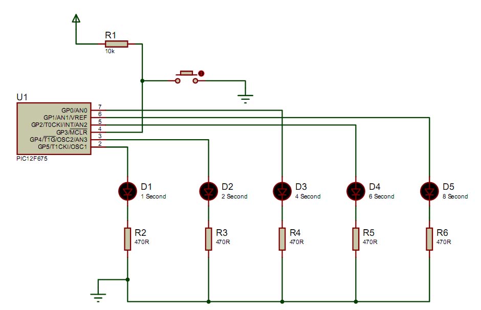

Hello All,
I have to make a Fish feeder Unit with 12F675. I have just an Idea about switching with 12F675. I make a schematic for 12F675 with switch.
Can you please someone guide me to make this?
Regards Manoj Soorya
NB: I think this forum is used to post about PIC Chips. If not, Please guide me. Sorry to post here.
This is my schematic.
But I dont have the code for to test the Unit...
If the switch is Press and hold (My timer output is enable for 1 Minute minimum) either Press, all LED will be ON.
After 1 Second, LED 1 Turn Off,
After 2 Second, LED 2 Turn Off
After 4 Second, LED 3 Turn Off
After 6 Second, LED 4 Turn Off
After 8 Second, LED 5 Turn Off.
(5 LED is used for Manual Timer selection for the Motor will Enable..)
any hope ?
Thank you
Well, no one is going to code it for you but we would be glad to help if you provide an attempt. However, this project is ideal for someone. If you think it might be too much for you to handle, you could try using a PICAXE instead of a PIC. A PICAXE is just a PIC pre-loaded with an interpreter to make it easier to code for (but will run slower than coding it directly). The 8-pin PICAXE should be almost the exact, if not the exact same chip as the 12F675.
Don't forget that you have to get the code from your computer to the PIC. This normally takes a little bit of extra wires going to the PIC and a programmer box sitting between the computer and board, unless you have a way to program the chip directly before putting it into the circuit.
In your circuit though, don't you have to drive a motor of some kind? I don't see any motors. The PIC cannot drive a motor directly from it's pins (can't provide enough current). So at the very least, you need to drive a transistor with the PIC, and the transistor drives the motor.
Also, you need current limiting resistors in series for your LEDs. If you have too many LEDs on at the same time, the PIC will also not be able to drive them due to current limits. In that case, you would have to use a transistor with each LED (very similar to the motor) and drive the transistor with the PIC.

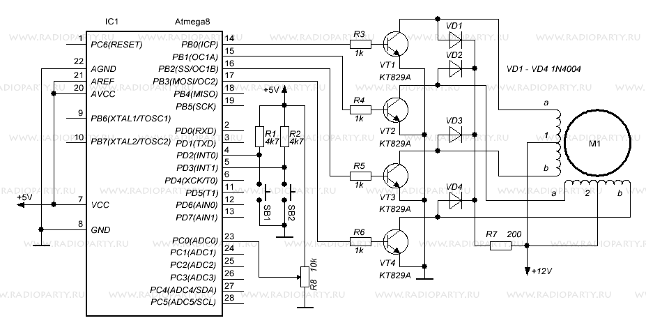

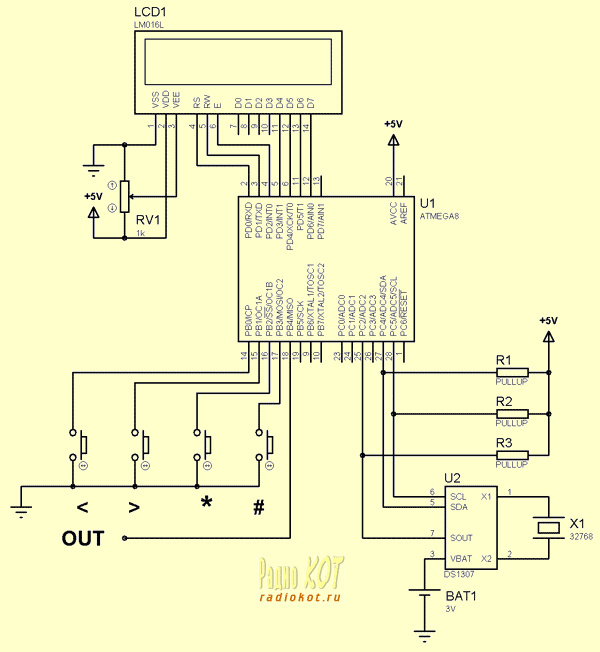

OK. I have already built a 24Hour Timer. Its output is minimum 1 Minute Enabled.
I have also a Stepper Motor Driver with Forward/Reverse Switch. Its working Perfect.
Schematic is Here
and this is the schematic of Timer
and the 12F675 is to connect between timer and the Motor controller Switch. (either Lefr/Right)

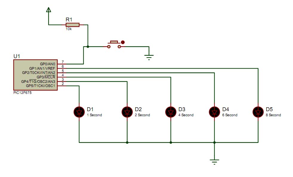

New schematic is Upload.
Is this okey now sagor1?
I am trying to write the programme.
Schematic looks better now. Always remember that the I/O pins are limited to 25mA each, and all I/O together are limited to 125mA total for the entire chip. Your schematic meets those limits ok, since each LED will be drawing about 10mA each...
Also remember that the internal oscillator, if not calibrated (PicKit2 can calibrate clock in a 12F675), can be a fair bit off frequency, 10% or more. Keep that in mind when writing timing loops and the LEDs turn on/off at different times than expected.
Also, if you want accurate timing, you have to read the calibration value via ASM code, and write it into OSCCAL register. See the datasheet section 9.2.5 for details

0046   0085           00174     movwf   GPIO
0047   2???           00175     goto    CheckSwitch
0048                  00176 LED4_off:
0048   3002           00177     movlw   B'00000010' ; LED1-4 off
0049   0085           00178     movwf   GPIO
004A   2???           00179     goto    CheckSwitch
004B                  00180 LED5_off:
004B   3000           00181     movlw   B'00000000' ; LED1-5 off
004C   0085           00182     movwf   GPIO
004D   2???           00183     goto    CheckSwitch
                      00184
                      00185 OSCCAL_CODE CODE 0x3ff
03FF                  00186 GetOSCCAL:
3FC4                  00187     end

1. Simple control stepper motor driver with speed control.
It is used to rotate a Stepper motor run in CW/CCW direction, only when the switch is pressed. The speed can Adjust.
2. In the switching section with 12F675 is used for automatic switching the stepper motor control Unit.
3. A simple timer used to set the Time to feed the fish. The output is connected to the 12F675 Switch. When the timer O/P is Enable, The 12F675 is also Enable. At the same time, The 5 Outrput of the 12F675 is also Enable. The output is connected to the Stepper Motor Driver Unit input (use only 1 input either CW/CCW) via a single pole five way Switch (SPFW Switch) or someting like that.
The reason for Selecting the Output Enable from 12F675, My timer minimum output Enable time is 1 Munite. Thats why the manual selector switch is used.
Please see my Previous Posts, I mensioned that the timer, Stepper Motor Driver and a video of another DIY automatic Fish feeder.
I like to combine the all three Unit in One...
I think you understand my Idea. Sorry for my poor English.
