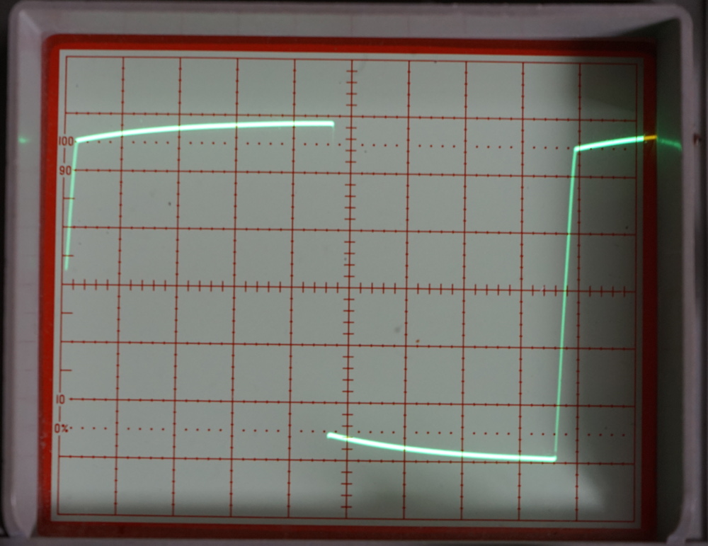

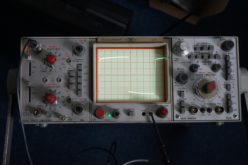

To expand a bit on my earlier post, I dug out my old Telequipment D75 'scope, and displayed the calibrator waveform:
Looking closely at the display:
The rising edges of the waveform can be seen quite clearly as a continuous line.
The falling edge is mostly absent because it is moving too fast for the phosphor on the CRT face to respond. If you look very carefully where the waveform starts to fall (top centre of the screen), the falling edge can be seen quite faintly.
If viewed in a dark room or through a viewing hood (who remembers those things?), it is possible that it may be clearly seen.
Note that this probe is not correctly compensated on this oscilloscope, as a result, the horizontal lines are not horizontal.
I was just about to complain about that :D
I thought that someone would pick up on that, which is why I mentioned it.
The D75 is not in daily use and only comes out to play when the fancy digital scope just cannot cut the custard.
As a result the probes are compensated to my Agilent digital scope.
The phosphor is responding fine, it's just that density of the electrons hitting the screen during the rise and fall time of a square-wave is far less than during the horizontal portion of the wave.
