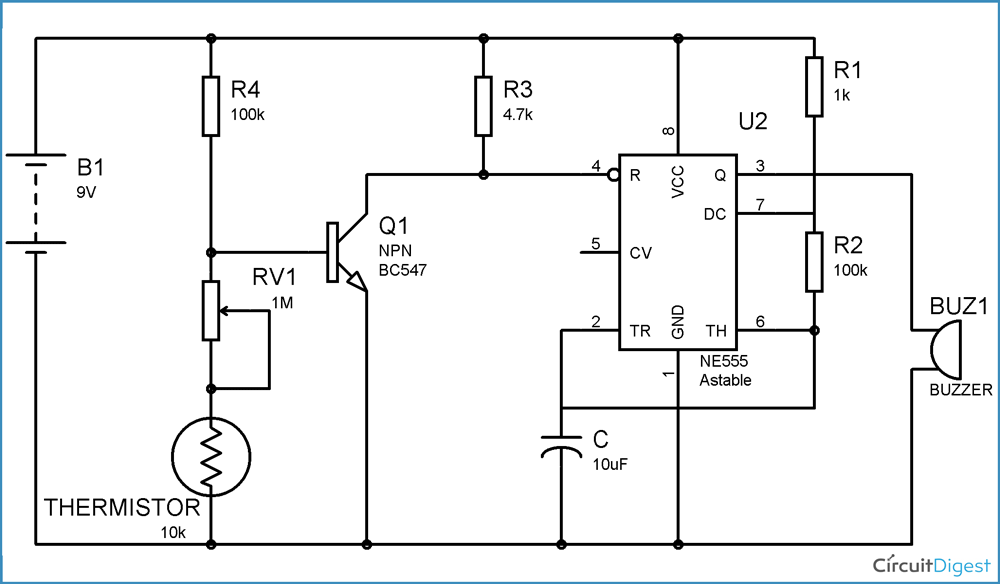

Good day. can anyone please help me by providing this circuits pcb design ?
connections cannot overlap as I'm planning to implement this on board.

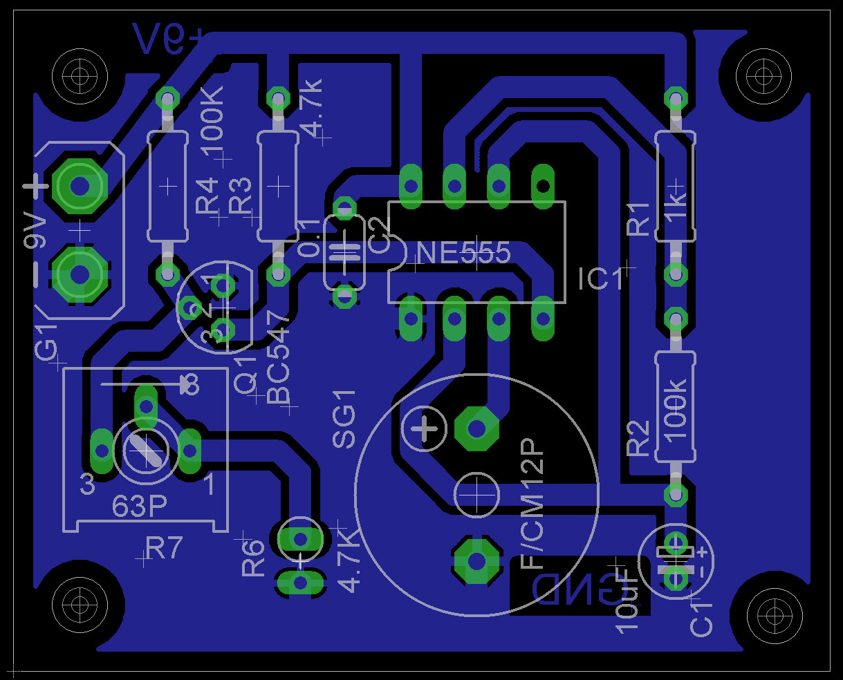

I have your layout file. Please PM with an email address so that I can send it to you.
nice board except he cap on pin 5 is not there as it should be. The schematic doesn't have it either.
Are you gong to etch your own board or ??
If you do it yourself then the image needs to be mirrored.

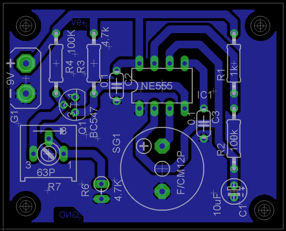

While I disagree that the capacitor on pin 5 is necessary in this case, it is harmless to include it in the layout.
