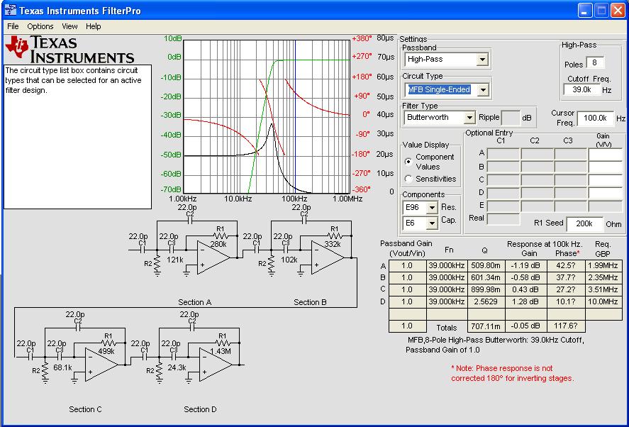

Your 8-pole highpass filter is biased correctly and should work. Except the TL074 opamp does not go high enough.

Filter Pro says to use high speed opamps, especially the 4th one. The TL074 is too slow for this filter.

I do not know any high speed opamp. what are they? Do you think LF411 and LF356 are high speed opamps?

It will work a lot better with the high speed opamps it needs.
The LF411 and LF356 are not high speed. Look at what is needed on the Filter Pro simulation then look at their datasheets. I have never used high speed opamps.

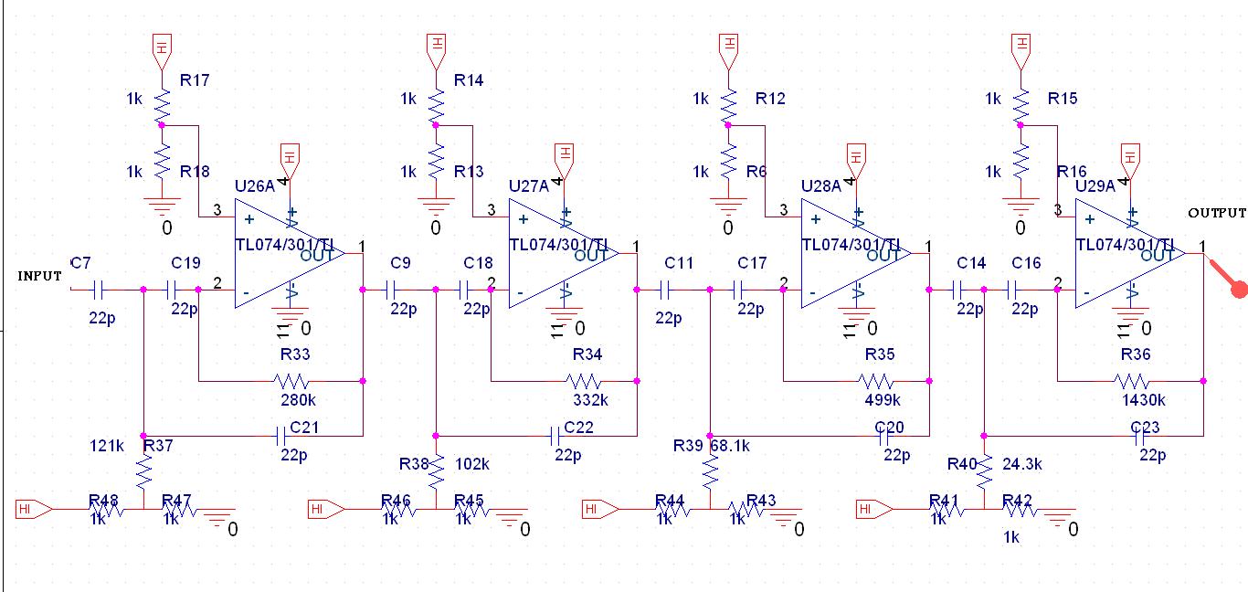

Ok I made the above 'Sallen –Key' filter in real with TL074.
Unfortunately it did not work at all (I do not know the reason).
So I went to design one filter based upon 'MFB Single-Ended'.
Now it does work but the output is gain seem to be less than one?

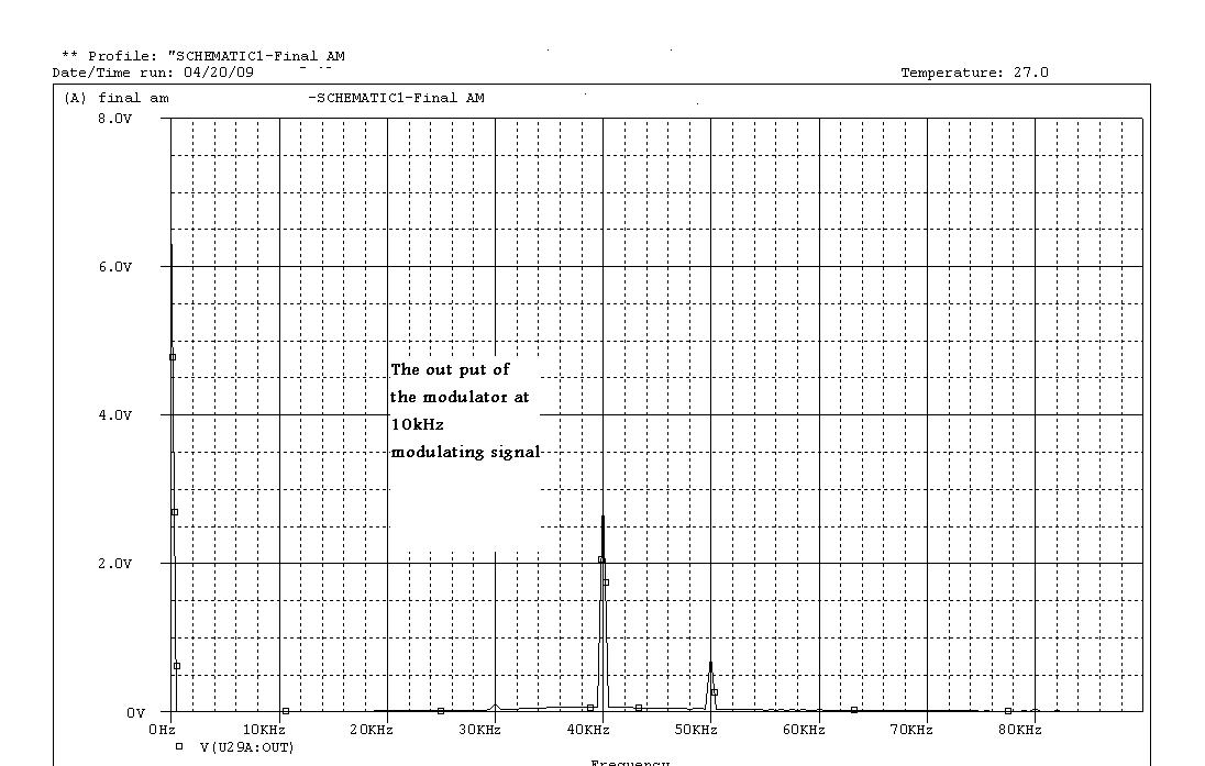

The bellow is the 'MFB Single-Ended' circuit designed by Filterpro and simulated by Pspice at 2kHz and then at 10kHz.
Because I am not able to put more than 3 pictures in a post I will post the FFT of the Pspice at 2kHz And 10kHz modulating signal in the bellow post.

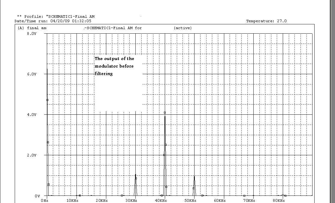

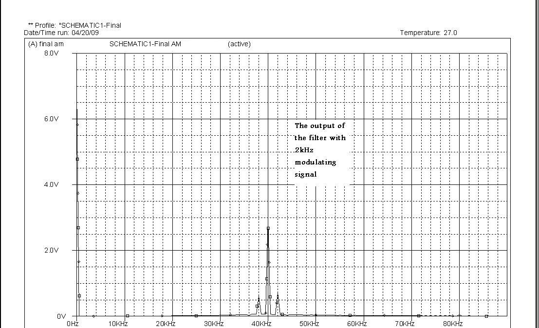

Here's the FFT of the signal at 2kHz, 10kHz.
How to improve the output signal of the filter?
Can I change the values of the filter I do some change in filterpro to get more gain from the filter?
The lower sideband as you can see exist at 2kHz modulating signal so what do do?

Your 39KHz fillter is only 1KHz about the lower sideband with a 2KHz modulation frequency. That's why so much of the lower 2KHz sideband gets through. You should go to a 40KHz filter. That will reduce the lower 2KHz sideband and still leave significant carrier feedthrough as you desired.
You could also go to a filter with a faster rolloff such as a Chebyshev. That will give you some ripple in the passband response, but that should be tolerable.

Which part are you meaning? Anyway the above circuit is exactly suggested by the Filterpro software.
