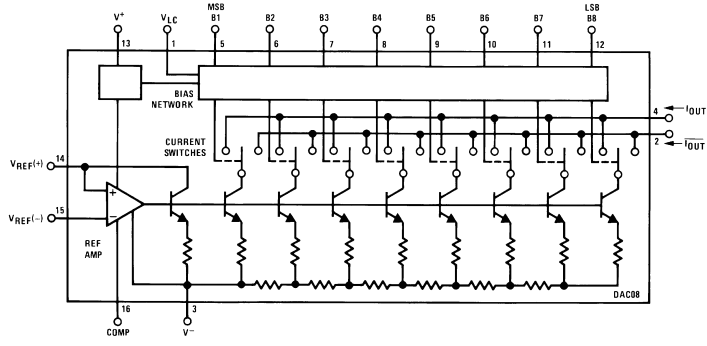

The schematic of the component :
My questions are :
- How do I chose Vref+ and Vref- ? What will be the difference between a 5V or a 15V differential voltage ?
-How do I chose V+ and V- ? Because on the output I only use the Iout currents (who are set with Iref).
So what will be the difference between a +/-5V or a +/-15V supply ?
- Do I have the choice for the Iref value ? What will be the difference if I chose Iref=2mA or Iref=1mA (speed, consumption) ?

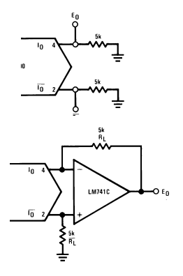

- On the output I'll have to transform the current into a voltage. In the datasheet they show different possibilities : with an AOP or directly with 2 resistor.
What are the advantages of using an AOP ?

If you chose a +/-5V supply, the Rref resistor would be 5V/0.002= 2.5K ie: 2mA Iref current.
So select the Rref so that a Iref is set as 2mA...
The +/-V supplies will determine the output swing range of the ADC.
I would always use a Buffer OPA on the outputs, so that the circuit the ADC is driving will not load the ADC output.

Ok for the use of an OPA on the output and the supply voltage (I forgot to tell you I will use a +/- 15V supply, but it doesn't change anything).
For Iref apparently I don't have the choice, it's 2mA and nothing else ?
For Vref I can chose whatever I want, the important is that I get Iref=2mA ?
What's going to happen if I chose Vref+ = 4V and Vref- =-1V. Does my circuit will still run ?
Does anybody knows if the Vref voltages are important while I have Iref=2mA :confused:

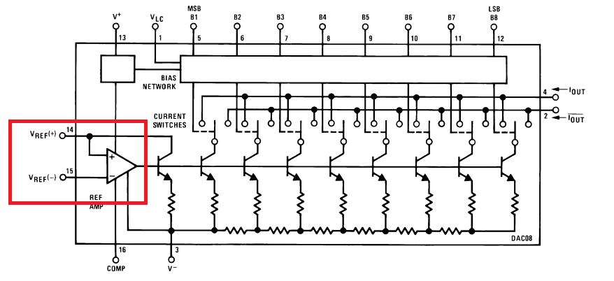

Yes I could use a +4V Vref, but I still don't understand what Vref- is used for.
On the schematic they show us a voltage comparator and I don't understand its role.
If I take a Vref- level too high I'll have voltage level too low on the output of my comparator ? All my bipolar transistors won't be able to draw enough current ?
For TTL logic inputs, connect VLC to 0v.
Set the Iref input to 1mA, with a +4v source use a 4K resistor to the Vref input pin and connect -Vref pin to 0v via a 4K resistor .
Look at page 4 of the datasheet at the Ifs/Iref graph.
On the I out pins connect a 1K resistor to 0v on each pin, this should give a +/-1V swing on the output voltage for a binary input code of 00h to FFh.
I would connect an OPA on the I outputs in order to buffer the DAC.
The Vref is misnamed IMO, its really a stable external voltage source which is used to drive the Iref current into the Vref pin. A series resistor from this external source sets the input Iref current and the OUTPUT currents..
Any external stable +V voltage source can be used to drive the +Iref input providing the current is limited to the specification in the d/sheet.
The lower the power supply to the DAC the lower the possible output current that be given at the Iouts, See the graph Page 4.
The +Vref and -Vref are the inputs to a 'long tail pair' transistor amplifier.
This type of transistor amplifier can accept bipolar inputs, also it can be used with a signal input on only one input, the other input is then connected to 0V or common via a resistor.
So in the DAC circuit +Vref is the pin with the signal input ie: 1mA ,,, the other pin -Vref is connected to 0V.
In order to give the optimum operation of the long tailed pair amplifier, the unused pin ie: -Vref is connected to 0V thru the same value resistor as the +Vref
