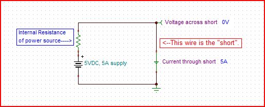

...How can you have zero volts and 5 amps , that doesn't make sense ...
Billy, work the math. Perhaps this will help you understand. This SIM was using Texas Instruments TINA.
ANY other simulator will give you identicle results.
We are trying to help you understand what you are doing and why you get the results that you do.
You can help us by, if nothing else, simply accepting the explanations you are given, even if you can't comprehend the why of the answer.
Some things is life have to be taken on faith if one is unable to grasp the basics...

froget water level and stay with a closed pipe system, where voltage relates to pressure difference. So if you have two tanks connected by a thin pipe and push water through it, there will be big difference in pressure between the two tanks. If the pipe is big (infinitely big) there will be no pressure difference and thus no voltage drop in equivalent electric system.
A DEAD short is zero ohms. It conducts A LOT of current but it has 0V across it. It does not get hot.
The pcb traces feeding the current to the short might have a resistance of 1 ohm so the current is 5V/1 ohm= 5A and the pcb traces dissipate 5V x 5A= 25W and burn out.
OR
You have an IC with a partial short of 1 ohm. Then the 5V supply has a load of 1 ohm + 1 ohm= 2 ohms. The total current is 5V/2 ohms= 2.5A. The voltage is divided so the IC dissipates 2.5V x 2.5A= 6.25W and the pcb traces also dissipate 6.25W. Maybe the IC and the pcb traces burn out.
Oh Ok i get it know thanks guys
