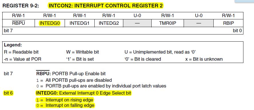

Now the next step is to make it function on the falling edge (5V to 0V)
Thanks for your help
In the tutorial attached before, it tells you to set register 'option' bit 6 to 0 for the the interrupt to occur at the falling edge.
When this was done, the below error was given:
"Symbol not previously defined (OPTION)"
Ok, i had to clear bit 6 of register INTCON2:
Finally the program is ready and working as expected... :)
