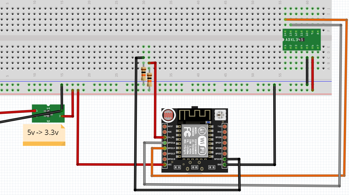

I'm trying to connect ADXL345 sensor to ESP8266 12-F:
ADXL345
https://www.ebay.com/itm/GY291-ADXL...156056&hash=item2a261d5260:g:Fr8AAOSwbwJZ7t3F
ESP:
https://www.aliexpress.com/item/new...2f-46bd-ab34-71796a9b83d5&transAbTest=ae803_5
I'm using GPIO14 and GPIO16 as SCL/SDA. See the circuit photo attached.
Using an oscilloscope between GND + SCL and GND + SDA I can see a some binary protocol working, but the I2C scanner software does not find the device. I'm using a scanner sketch from (Made only the required changes for the ESP to use it):
One thing I've noticed with the oscilloscope is that the default value reading is HIGH - I'm not sure if this is ok.
Is something wrong with the connections I'm using? I read something about needing pull ups for the ESP pins - not sure if it is needed.

ok so i tried the following connections:
GND GND
3V3 VCC
3V3 CS
GND SDO
GPIO16 SDA
GPIO14 SCL
SDA, SCL are pulled up to 3.3v with 10k resistors. still - I2C scanner fails to find it.

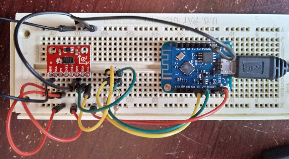

Yes, here is another idea. With your setup above, change SCL/SDA to these:
GPIO14 (D5) --> SCL
GPIO12 (D6)--> SDA
Use this scanner https://github.com/jainrk/i2c_port_address_scanner Don't modify it at all. If it scrolls by too quickly or if you want to change pins and test again, just reset the ESP12.
Using a Weemos D1 v3.0 and your setup with my changes above (except I use 4.7k pull ups), I get:
11:12:23.392 -> Scanning (SDA : SCL) - GPIO12 : GPIO14 - I2C device found at address 0x53 !
If I use GPIO16, I get no devices found. I can't remember why exactly, but there may be some ESP8266 peculiarity on the pin pairs. I thought it was all bit-banged, but why fight the results?
Using the scanner that I linked is a convenience as you don't have to mess with the args in wire.begin and you can futz with the pairs you want.
Edited to add: Below is the setup I just used for testing in case you want to compare wiring. I wonder if your ESP8266 board/circuit is using GPIO16 for something?
GPIO14 (D5) --> SCL
GPIO12 (D6)--> SDA
.View attachment 118969
Hope this helps.
man - thanks for the detailed answer! it works with my own sketch now - the problem was GPIO16 - i changed to GPIO12 instead and both My sketches work now - I2C scanner and the AXIS reader- Thanks!
