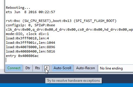

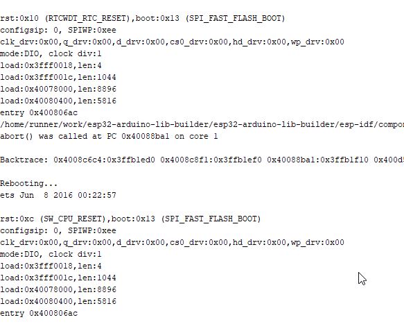

Thought this might be of help / interest to other novice ESP32 C++ code writers.
Opened up an old project code, should have been ok, but when running it on its test board, it kept rebooting after a few seconds ?
The Arduino IDE showed no compile error, but when we opened the Serial Monitor it showed it was doing a SW CPU RESET - though that instruction, ESP.restart(); is not in our code ?
Seemed no obvious way to locate the error, other than a long time working though the 2,000 lines of code or looking at / trying to find an Assembly listing for those code numbers shown at the end of the Serial Monitor listing Entry 0x400806ac ?
Tried running it on Atmel Studio , again no compile errors but still Resetting.
However on Studios Serial Monitor there is this little ' ! ' icon which clicked, brought up a new Output window , this time with Error codes.
The fault was traced to this line of code being commented out in error, but still not sure why a compile error was not given ?
// pwm , channel, freq, resolution
// ledcSetup(1,1000,8);
// led pin , pwm channel
ledcAttachPin(15,1);
3 Pics below -
Adruino IDE
Atmel Studio Serial Monitor
Atmel Hardware Error Output
