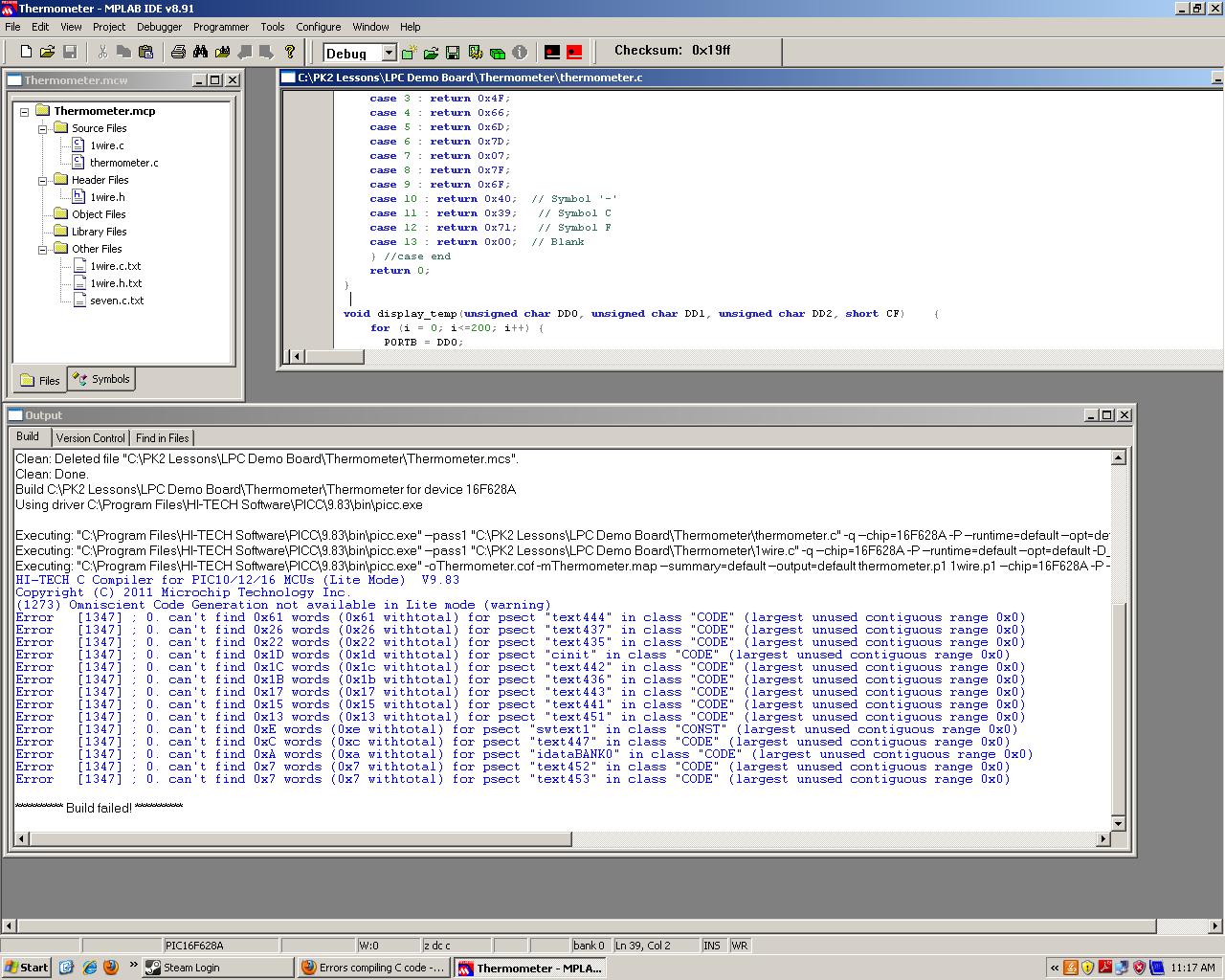

Here's the error message:
Build C:\PK2 Lessons\LPC Demo Board\Clock_Temp\Clock_temp for device 16F628A
Using driver C:\Program Files\HI-TECH Software\PICC\9.83\bin\picc.exe
Make: The target "C:\PK2 Lessons\LPC Demo Board\Clock_Temp\clock.p1" is out of date.
Executing: "C:\Program Files\HI-TECH Software\PICC\9.83\bin\picc.exe" --pass1 "C:\PK2 Lessons\LPC Demo Board\Clock_Temp\clock.c" -q --chip=16F628A -P --runtime=default,+clear,+init,-keep,+osccal,-download,-resetbits,-stackcall,+clib --opt=default,+asm,-debug,-speed,+space,9 --warn=0 -D__DEBUG=1 --debugger=icd2 -g --asmlist "--errformat=Error   [%n] %f; %l.%c %s" "--msgformat=Advisory[%n] %s" "--warnformat=Warning [%n] %f; %l.%c %s"
Warning [343] C:\PK2 Lessons\LPC Demo Board\Clock_Temp\clock.c; 35.1 implicit return at end of non-void function
Error   [192] C:\PK2 Lessons\LPC Demo Board\Clock_Temp\clock.c; 39.1 undefined identifier "PORTB"
Error   [192] C:\PK2 Lessons\LPC Demo Board\Clock_Temp\clock.c; 40.1 undefined identifier "RA0_bit"
Error   [192] C:\PK2 Lessons\LPC Demo Board\Clock_Temp\clock.c; 41.1 undefined identifier "RA1_bit"
Error   [192] C:\PK2 Lessons\LPC Demo Board\Clock_Temp\clock.c; 42.1 undefined identifier "RA2_bit"
Error   [192] C:\PK2 Lessons\LPC Demo Board\Clock_Temp\clock.c; 43.1 undefined identifier "RA3_bit"
Warning [361] C:\PK2 Lessons\LPC Demo Board\Clock_Temp\clock.c; 44.1 function declared implicit int
Error   [192] C:\PK2 Lessons\LPC Demo Board\Clock_Temp\clock.c; 69.1 undefined identifier "CMCON"
Error   [192] C:\PK2 Lessons\LPC Demo Board\Clock_Temp\clock.c; 70.1 undefined identifier "TRISB"
Error   [192] C:\PK2 Lessons\LPC Demo Board\Clock_Temp\clock.c; 71.1 undefined identifier "PORTB"
Error   [192] C:\PK2 Lessons\LPC Demo Board\Clock_Temp\clock.c; 72.1 undefined identifier "TRISA0_bit"
Error   [192] C:\PK2 Lessons\LPC Demo Board\Clock_Temp\clock.c; 73.1 undefined identifier "TRISA1_bit"
Error   [192] C:\PK2 Lessons\LPC Demo Board\Clock_Temp\clock.c; 74.1 undefined identifier "TRISA2_bit"
Error   [192] C:\PK2 Lessons\LPC Demo Board\Clock_Temp\clock.c; 75.1 undefined identifier "TRISA3_bit"
Warning [361] C:\PK2 Lessons\LPC Demo Board\Clock_Temp\clock.c; 83.1 function declared implicit int
Error   [192] C:\PK2 Lessons\LPC Demo Board\Clock_Temp\clock.c; 83.11 undefined identifier "PORTA"
Warning [361] C:\PK2 Lessons\LPC Demo Board\Clock_Temp\clock.c; 84.1 function declared implicit int
Warning [361] C:\PK2 Lessons\LPC Demo Board\Clock_Temp\clock.c; 93.14 function declared implicit int
Warning [361] C:\PK2 Lessons\LPC Demo Board\Clock_Temp\clock.c; 108.14 function declared implicit int
Warning [356] C:\PK2 Lessons\LPC Demo Board\Clock_Temp\clock.c; 114.23 implicit conversion of float to integer
********** Build failed! **********

Never compiled a C file at all. On top of that, I don't know much about C or machine language. I've had some experience with basic 20 something years ago but that's all. Makes me wish I kept down the electrical engineering path in college but life gets in the way sometimes.
Ok, that's what I thought and tried. I am using MPLAB IDE. I started a new project, I added the 3 text files (1wire.c, 1wire.h, and seven.c) to the project. Then 1 at a time I opened a blank page, copy and pasted the text of each and saved them as 1wire.c, 1wire.h, and renamed seven.c to thermometer.c. I then added each to the project and put them in the appropriate folders, thermometer.c and 1wire.c both went in the source folder and 1wire.h went in the header folder. I also changed the code of thermometer.c to this:

Hopefully I changed the "short" to "unsigned char" in all the correct places. I didn't edit the config yet, trying to get it to assemble properly first.
If I've I done everything correctly I still get errors, though they're different than last time,
Clean: Deleting intermediary and output files.
Clean: Deleted file "C:\PK2 Lessons\LPC Demo Board\Thermometer\thermometer.p1".
Clean: Deleted file "C:\PK2 Lessons\LPC Demo Board\Thermometer\1wire.p1".
Clean Warning: File "C:\PK2 Lessons\LPC Demo Board\Thermometer\Thermometer.cof" doesn't exist.
Clean Warning: File "C:\PK2 Lessons\LPC Demo Board\Thermometer\Thermometer.hex" doesn't exist.
Clean: Deleted file "C:\PK2 Lessons\LPC Demo Board\Thermometer\Thermometer.sym".
Clean: Deleted file "C:\PK2 Lessons\LPC Demo Board\Thermometer\Thermometer.map".
Clean Warning: File "C:\PK2 Lessons\LPC Demo Board\Thermometer\Thermometer.hxl" doesn't exist.
Clean: Deleted file "C:\PK2 Lessons\LPC Demo Board\Thermometer\startup.lst".
Clean: Deleted file "C:\PK2 Lessons\LPC Demo Board\Thermometer\startup.rlf".
Clean Warning: File "C:\PK2 Lessons\LPC Demo Board\Thermometer\doprnt.p1" doesn't exist.
Clean Warning: File "C:\PK2 Lessons\LPC Demo Board\Thermometer\doprnt.pre" doesn't exist.
Clean: Deleted file "C:\PK2 Lessons\LPC Demo Board\Thermometer\Thermometer.obj".
Clean: Deleted file "C:\PK2 Lessons\LPC Demo Board\Thermometer\Thermometer.lst".
Clean: Deleted file "C:\PK2 Lessons\LPC Demo Board\Thermometer\Thermometer.rlf".
Clean: Deleted file "C:\PK2 Lessons\LPC Demo Board\Thermometer\Thermometer.sdb".
Clean: Deleted file "C:\PK2 Lessons\LPC Demo Board\Thermometer\Thermometer.mcs".
Clean: Done.
Build C:\PK2 Lessons\LPC Demo Board\Thermometer\Thermometer for device 16F628A
Executing: "C:\Program Files\HI-TECH Software\PICC\9.83\bin\picc.exe" --pass1 "C:\PK2 Lessons\LPC Demo Board\Thermometer\thermometer.c" -q --chip=16F628A -P --runtime=default --opt=default,+asm,-debug,-speed,+space,9 --warn=0 -D__DEBUG=1 -g --asmlist "--errformat=Error   [%n] %f; %l.%c %s" "--msgformat=Advisory[%n] %s" "--warnformat=Warning [%n] %f; %l.%c %s"
Executing: "C:\Program Files\HI-TECH Software\PICC\9.83\bin\picc.exe" --pass1 "C:\PK2 Lessons\LPC Demo Board\Thermometer\1wire.c" -q --chip=16F628A -P --runtime=default --opt=default -D__DEBUG=1 -g --asmlist "--errformat=Error   [%n] %f; %l.%c %s" "--msgformat=Advisory[%n] %s" "--warnformat=Warning [%n] %f; %l.%c %s"
Executing: "C:\Program Files\HI-TECH Software\PICC\9.83\bin\picc.exe" -oThermometer.cof -mThermometer.map --summary=default --output=default thermometer.p1 1wire.p1 --chip=16F628A -P --runtime=default --opt=default -D__DEBUG=1 -g --asmlist "--errformat=Error   [%n] %f; %l.%c %s" "--msgformat=Advisory[%n] %s" "--warnformat=Warning [%n] %f; %l.%c %s"
HI-TECH C Compiler for PIC10/12/16 MCUs (Lite Mode)  V9.83
Copyright (C) 2011 Microchip Technology Inc.
(1273) Omniscient Code Generation not available in Lite mode (warning)
Error   [1347] ; 0. can't find 0x61 words (0x61 withtotal) for psect "text444" in class "CODE" (largest unused contiguous range 0x0)
Error   [1347] ; 0. can't find 0x26 words (0x26 withtotal) for psect "text437" in class "CODE" (largest unused contiguous range 0x0)
Error   [1347] ; 0. can't find 0x22 words (0x22 withtotal) for psect "text435" in class "CODE" (largest unused contiguous range 0x0)
Error   [1347] ; 0. can't find 0x1D words (0x1d withtotal) for psect "cinit" in class "CODE" (largest unused contiguous range 0x0)
Error   [1347] ; 0. can't find 0x1C words (0x1c withtotal) for psect "text442" in class "CODE" (largest unused contiguous range 0x0)
Error   [1347] ; 0. can't find 0x1B words (0x1b withtotal) for psect "text436" in class "CODE" (largest unused contiguous range 0x0)
Error   [1347] ; 0. can't find 0x17 words (0x17 withtotal) for psect "text443" in class "CODE" (largest unused contiguous range 0x0)
Error   [1347] ; 0. can't find 0x15 words (0x15 withtotal) for psect "text441" in class "CODE" (largest unused contiguous range 0x0)
Error   [1347] ; 0. can't find 0x13 words (0x13 withtotal) for psect "text451" in class "CODE" (largest unused contiguous range 0x0)
Error   [1347] ; 0. can't find 0xE words (0xe withtotal) for psect "swtext1" in class "CONST" (largest unused contiguous range 0x0)
Error   [1347] ; 0. can't find 0xC words (0xc withtotal) for psect "text447" in class "CODE" (largest unused contiguous range 0x0)
Error   [1347] ; 0. can't find 0xA words (0xa withtotal) for psect "idataBANK0" in class "CODE" (largest unused contiguous range 0x0)
Error   [1347] ; 0. can't find 0x7 words (0x7 withtotal) for psect "text452" in class "CODE" (largest unused contiguous range 0x0)
Error   [1347] ; 0. can't find 0x7 words (0x7 withtotal) for psect "text453" in class "CODE" (largest unused contiguous range 0x0)
Here's my workspace,
