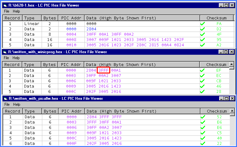

Ok. Gregmcc now its your chance to help with one final important piece of information before this thread can offically close.
1. Using Winpicprog, programs the PIC with your original blinking LED code and expect failure in verify. Exit program.
2. Startup PicAllW and just read the PIC. Post the content of the HEX file read from the PIC.
Can you do that for us?

i've attached the results.
the original file (b628-1.hex) was written using WinPICProg.
I then used PICAllW to read the pic - the results saved to written_with_winicprog.hex
I also wrote the original file and read it back using PICAllW - the result is written_with_picallw.hex

Hi gregmcc,
Thanks for the results. I have checked them and found the error a liitle different to those previously mentioned. The data is shifted together with a 4 bits error.
The image shows the error location.
I'm afraid the problem is somewhere in between the communication of the PC and your programmer where there is a short break in programming activities. WinPicProg does not program the "empty" bytes so it is possible that the above error occurs during this time. By using a file with no gaps in it, I'm forcing WinPicProg to continously occuplying the CPU time without break so the programming is sucessful. The file works OK with PicAllW because all the bytes in the buffers, including those "3FFF" are being send to the PIC regardless so there is no break in the programming activities also.
This is only my guess. Yesterday, I have done some experiment too using the same file and WinPicProg on my PC. I cannot recreate the problem you've met and all the programming is sucessful. You can see the thread here:
PIC programmer & WinPicProg: my findings
This type of problems are common and happens with unique PC/OS/software combinations. Just sticks with one that works with your current setup and you are fine.
