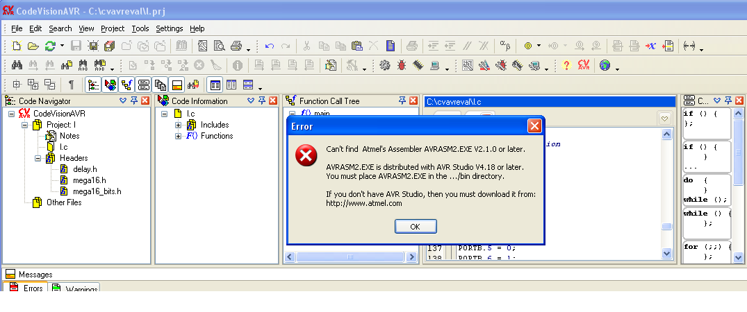

Hi why I am getting this error in the software why push the "build" button while I have the said file in my bin folder?
Thanks a bunch

Have you installed AVR Studio 4 from ATMEL ?
Install that- I think that will solve the Problem.
