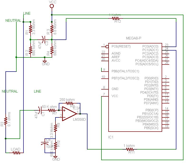

hello folks,
im planning to build an energy meter for 230V, 2A and around 5% accuracy using an 8bit AVR microcontroller. My inspiration is AVR465 application note .. https://www.electro-tech-online.com/custompdfs/2007/02/doc2566.pdf
The first challenge that i faced is whether to use a tranformerless powersupply or not..

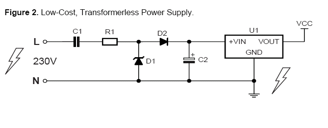

In the application note mentioned above, a transformerless power supply was used (see power supply.png attachement) where this was the description given "The power supply is based on halfway rectification. During negative half-wavescapacitor C1 is charged and during positive half-waves the capacitor is drained.Zener diode D1 (minus the forward voltage of diode D2) dictates to which voltage C2 is charged. Voltage regulator U1 uses the energy stored in C2 to produce a stable output voltage. Resistor R1 controls the charge and discharge of C1 and also limits the current flow through zener diode D1."
where C1 is 0.68uF Metallised Polyester Capacitor, R1 is 470ohms , D2 1N4004 is Diode, 1A, 400V, D1 is Zener Diode , 500mW, 15V .
C2 is 470 uF electrolytic capacitor, U1 is Linear Regulator, 3.3V.
I wish to replace U1 with 7805 regulator to get 5V output.
I trust Atmel people very much but wished to hear from Senior members of electro-tech-online. please see this and review the circuit( is it safe, would it have any side effects ?)
The second challenge is the current front end. I have a 10:1 current transformer and the one that was specified in the application note was 2500:1 far different from the one i have... So i have decided to use a series resistor 0.1 ohms between line,load and neutral and measure the voltage across the resistor(refer to current.png in attachments) by giving it to microcontroller's inbuilt analog to digital converter through an amplifier built using lm358 with gain just enough to bring it in the range of the in built voltage reference 2.56V in the microcontroller.
for example max current =2A rms
voltage across resistor=2A * 0.1 ohms = 200 mV rms
after an opamp amplifier with gain 4. voltage is 200 mV *4= 800 mV rms=2 *square root(2) *.8 peak to peak approx 2.56 V
I was wondering if this would be a safe way to measure current
suggestions and advice greatly appreciated...

Without looking in any great depth, ( which means I've missed a lot) , I have a couple of points to make. Firstly, resistors have a voltage rating, the standard half-watt ones being 250 volts peak. If you exceed this, they tend to go all nasty and non-linear. Use two or three lower value ones in series for the high voltage bits. The capacitors, at 47uf, look well large enough to cause no trouble, but beware of phase shifts if you use lower values.

You have an ordinary old LM358 dual opamp. The circuit is supposed to have an LMV358 new one which has a rail-to-rail output voltage swing. You have its input incorrectly biased.

thank you @audio guru. Im gonna replace lm358 with lmv358

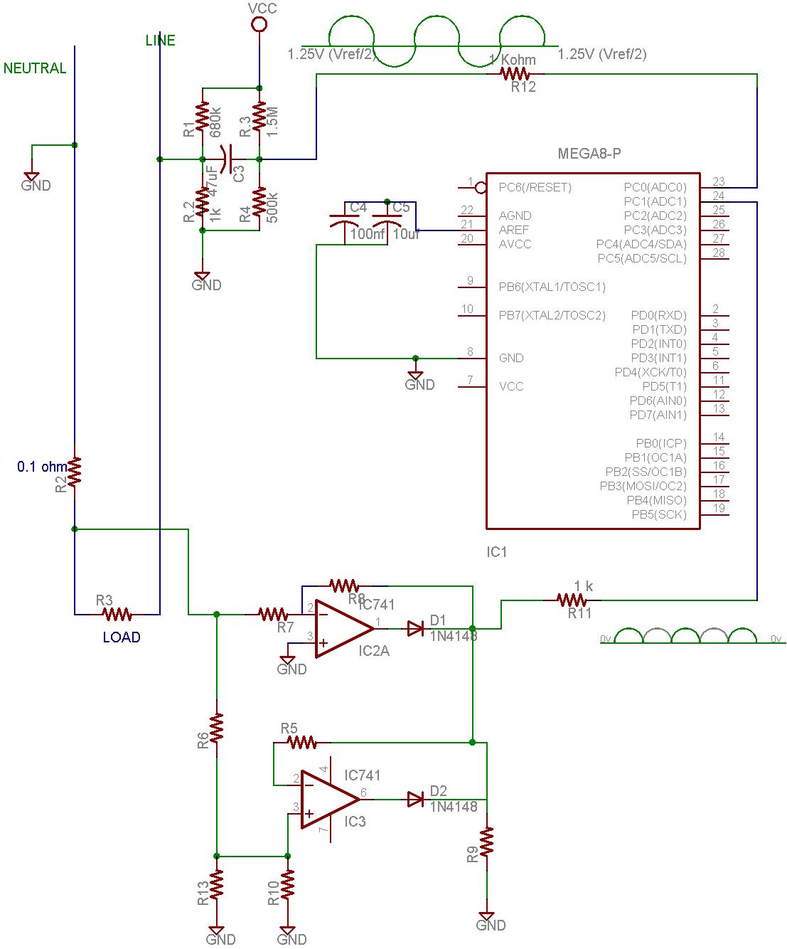

Hero999,
i have redesigned the circuit as you suggested (see circuit2.jpg)
The problem with that circuit is that the component names are not clear in the picture can you help me with that. And can i use IC741 as opamp or any better suggestions. I'd need a gain of 8 such that for 2 A current
the voltage across the 0.1 ohm resistor R2 is 200mV rms (200*1.414 mV Vp) and the output of the opamp would be (200*1.414 *gain mV Vp)=(200*1.414*8)mV Vp= 2.26V which would fall under the reference voltage of the microcontroller Vref=2.56V

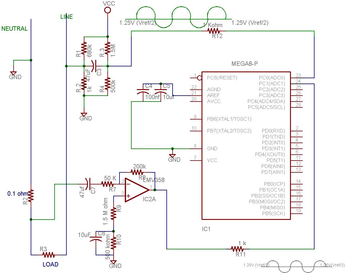

. Have also modified my previous design(see circuit1.jpg) where i didnt use dual power supply and used lmv358 but DC biased to adjust the signal to fit between 0 to Vref.
which one is better?? any suggestions?
currently im testing them both ..

I se there are various opinions on this . No low pas filters are to be used, unles you are also using input rectifiers. If using rectifiers you are restricted to pure resistive loads, anything with a reactive component wil give ridiculous erors. The inputs should be biased to half the range of the adc. A god way to calibrate is to set up with a resistive load and a couple of multimeters, and bung a fat paper capacitor acros the load. As long as the curent is stil within range of the adc, there should be no change in the power reading.
Excuse the speling, I am fed up with corecting this keyboard which wil not type double leters. Filterkeys is OF.
You can't use an old 741 opamp because it needs at least plus 5V and minus 5V to power it, its inputs don't work when they are anywhere near the positive or negative supply voltage and the output doesn't swing very far.
When biased properly, the LMV358 works fine from a single 5V supply, its inputs work down to 0V and its output swings the full supply voltage (rail-to-rail).
It doesn't matter, it's low frequency so use the LM741, TL084, LM324 etc. Do watch the current consumption though if you're using a transformerless power supply as it can't provide more than about 15mA depending on the size of the capacitor.
If you can't read the resistor component labels then just remmeber it's simple an inverting and non-inverting amplifier connected together with diodes in their outputs, the formula for the gain is identical to the formua for an inverting and non-inverting amp.

Swap the 5.1V zenners for 12V zenners, assuming the PIC can take 12V, if not use a separate 5V regulator for the PIC.
It gets complicated if you use an old 741 opamp to feed the 5V max input to a pic. With a 5V supply, the output high voltage of the 741 will be very low. With a 12V supply it is much too high.
The Cmos inputs of a PIC have protection diodes that can protect the input from a signal voltage that is too high if you use a series resistor to limit the current.
:-? im confused now... i tried to get myself lmv358 but its out of stock here and unavailable. Shall i go ahead with IC741 and a seperate 12 supply. Micro controller can take till 5V only...
If you can't read the resistor component labels then just remmeber it's simple an inverting and non-inverting amplifier connected together with diodes in their outputs, the formula for the gain is identical to the formula for an inverting and non-inverting amp.

and i better change to a transformer powersupply to avoid current consumption prob..

I have tried to construct a tranformerless dps based on your suggestion. Please refer to your post in the above mentioned thread. I have observed that 1M ohm was giving an output of 3.6V, -3.6V
500kohm 3.9v,-3.9v
250kohm 4.2v,-4.2v
100kohm 4.79V,-4.79V
so finally i decided to go with 100kohm , but when i connected this supply to TL084 the voltage across the rails dropped to 2.5V. Again when i disconnect the supply from tl084 it shows 9.54V(4.8v-(-4.8v))
can you please tell me how could i modify this to use the dual power supply design that you suggested..
your circuit seems to work fine when used with lm358 or anything else but not tl084 . i wonder why.. what could have not favoured for tl084.

Thje LM358 has low power opamps. The LM324 is its quad version.
Look at the supply current for the different opamps on their datasheets:
LM358= 0.5mA to 1.2mA for each opamp. Four is 2.0ma to 4.8mA.
TL084= 1.4mA to 2.5mA for each opamp. Four is 5.6mA to 10mA.
You are changing the wrong component value, to get more current you need to increase the value of the 470nF capacitor. The 1M resistor is just a bleeder resistor that discharges the capacitor when the power is disconnected.
Also don't use any more op-amps than you really need, don't use a quad if you only need two opamps and if you need three use a dual and a single op-amp.
