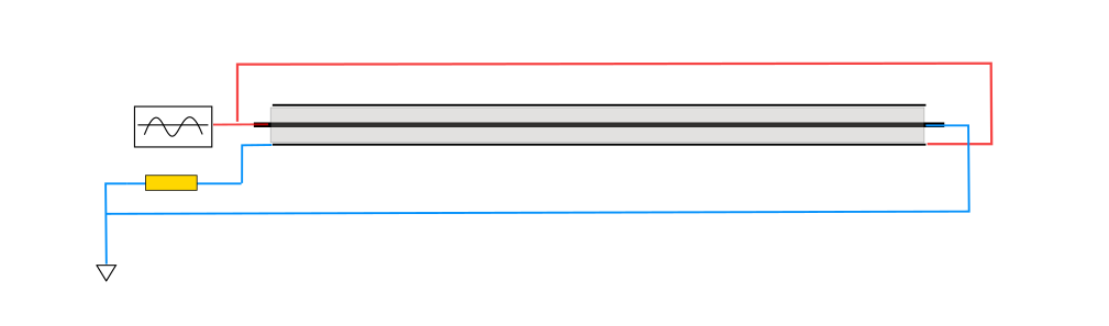

Another thought. Would it be practical to simply wire a small value resistor in series with the core of the coax so that its resistance matches that of the shield?
Feeding both ends with an opposite balanced signal would cause the cable to act as an antenna and radiate.
With a balanced signal from one end, the coax loses out as the resistance of the two halves of the circuit are different (core vs screen) so the endpoint junction will have voltage on it due to the unbalanced resistive divider.

I am not following this. What I was proposing in that instance is to create two parallel currents in adjacent wires of the cable but flowing in opposite directions. In my mind, that seems more efficient than simply shorting the distant end.
I understand the problem you describe with the coax. But if I drive the coax from both ends as above, the voltage difference would occur on the core side only, not a common point. Why then could I not insert a compensating series resistor at the connection to the signal source?

This is the coax wiring described in the second paragraph
above.

In the context of my original post, can someone please comment on my diagram above showing the series termination resistor as a proposed method to equalize (balance) the resistances of the coax core and shield?
