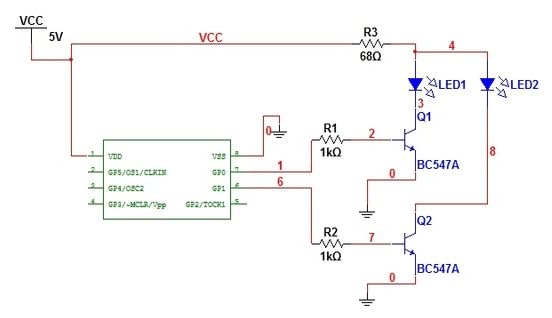

Emergency Double Strobe Flip/Flop - Double flash flip/flop with a PIC12
Notes:
  • Any switching NPN transistor will work.
  • U1 = PIC12Fxxx (675/629/684), check your datasheets to see if others will work with this.
Schematic
Code
