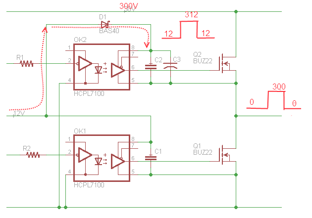

I hope you don't mind me bringing up this old thread. I don't quite understand how, in the bottom circuit, the capacitor gets charged when the FET is turned on.
The battery is at 12+ which turns on the FET and pulls up the source to about 300+ which means that the capacitor will have one side connected to 12+ and the other side to 300+. How does it gets charged to 312+? Doesn't need a negative or ground?
And what happens to the battery when we connect its negative side to 300+?
I'm quite a newbie so excuse me if the questions seem too simple.

It has been a long time and I don't remember where we are.
BOTTOM:
This is simple. The driver output sits on the Source of the MOSFET and drives the Gate. The Source is on ground.
TOP:
No so simple. The driver output sits on the Source of the top MOSFET and drives the Gate. The top Source is on the output.
The output voltage is 0 volts or 300 volts. Pin 5 is not ground, it is output. When the bottom MOSFET is on it pulls pin5 to ground.
When the output is at 0 volts current flows from +12V through D1 and charges C2,C3 to about 12 volts.
When the output is high, 300V, pin 8 is at 312 volts. (pin 8 to pin 5 is 12 volts) D1 blocks current flow.
When the top MOSFET is on it pulls pin5 to 300 volts. C2,C3 is disconnected from +12V.

So there's circuitry that controls the sequence of turning on the MOSFETS and D1.
I got lost at the fourth line in your post. "When the output is high, 300V, pin 8 is at 312 volts. (pin 8 to pin 5 is 12 volts) D1 blocks current flow.". Which output?
After Q1 is turned off (i believe it has to be turned off before Q2 is turned on) C2 and C3 are charged to 12+ and D1 is reverse biased which means pin 8 is at 12+ .
Then OK2 is turned on bringing the gate of Q2 to 12+ and turning on the MOSFET ( obviously it happens gradually) which starts to pull its source up to 300+.
Then I get lost.
As the source is now positive and rising how is it going to charge two capacitors one of which is polarized and one is non (am I correct?) while they're connected on the other side to a 12+ coming through D1? Or is D1 now connected to ground?
Which output?
The output of Q1, Q2.
To charge up C2,C3 the bottom MOSFET must be on. This pulls pin5 to 0 volts or ground. Current will flow from +12V through D1 and into the caps.
The moment when the output of Q1,Q2 rises above 0 volts, D1 will open up and disconnect C2,C3 from the +12V.
When Q1= open and Q2=closed the bottom of C2,C3 will be almost 300 volts. Because C2,C3 is charged to where there is 12V across them the top of C2,C3 should be 300+12=312 volts.

I've been trying but I don't get it. I think I understand the circuit as whole but not how the caps are charging to 312+.
"The moment when the output of Q1,Q2 rises above 0 volts, D1 will open up and disconnect C2,C3 from the +12V."
What does that mean, how does D1 open? Is there a switch to disconnect it or do you mean reverse biases?
Accepting that D1 will "open up and disconnect C2 and C3 from the +12V and leave them charged to +12V.
OK, so now I have a capacitor charged to +12V and not connected to anything at all then I connect one plate to +300V and the other plate to nothing , how does it get charged up to +312V? I have one plate at 12+ and the other at +300.
Sorry, I know it's basic but I've spent the day reading about capacitor ad how to charge them and still don't get it.

The capacitor is charged to 12V, so one plate has 12V more than the other plate with respect to ground. So whatever voltage you have on the first plate, the other will be that plus 12V. So if the voltage is pulled to 300V above ground the other will be at 312V above ground, but the cap is still charged to the 12V it has between its plates.

Oh. So the idea wasn't to top up the cap to 312 but to use the 12v already in the cap to maintain the potential difference. I think I finally got it!
