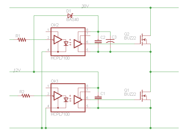

Here's the schematic as requested. As I said, the only issue is a pulse on the opto output when it is powered. Would prefer no output pulse without an input pulse...

Here is a H configuration.
I do not have the IC you are using, loaded in to my computer so I am using one that is different.
Pin-5 must go to the MOSFET-S!
Pin-6 goes to MOSFET-G.
Ron, Thank you for your post. This seems like a good way to control the H-Bridge, but would you help me understand how this keeps all four Mosfets from turning on simultaneously when the opto fires its output pulse during turn-on? Also, what type of capacitor is your C3 symbol, and is there no need for a C4 on OK1? Also, I see how this works with Pin 5 of OK2 going to the Mosfet -S, but can you help me understand why it must? Couldn't it go straight to ground as it does on OK1?

I do H bridges at 300 to 400 volts. Some people put the "top" gate driver on ground. They don't understand that the gate and source MUST be with in +/-20 volts. With the top MOSFET open and the bottom MOSFET closed. The top gate is at 0 volts. When it is time to have the top MOSFET on the driver lifts to 12V or 20V. This turns on the top MOSFET. Now the gate is at 20V and the source is at 300V. MOSFET and Driver are dead. Typical error.

30 volt supply is all the opto-isolator is good for. Most MOSFETs can only take +/-20V on the gate. (G to S) So the 30V might kill the MOSFET.
Next this is a IGBT driver not a MOSFET driver but that is probably OK.
