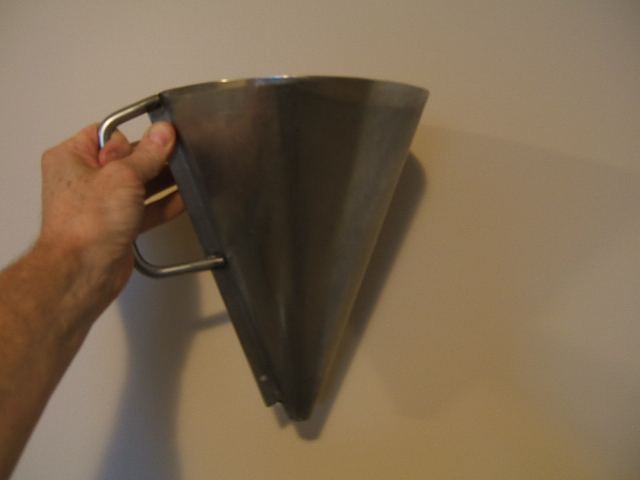

I need to keep this stainless steel funnel at a constant temp of 150-250 degrees F. The funnel is used to hold and meter out liquid boiled sugar in the making of hard candy. I was wondering what materials, controllers, and circuit I'll need. The circuit should include some type of thermocouple for control because once the correct temp is found I'll need to keep the boiled sugar at a constant temperature. I'm also considering insulating the funnel with some kind of heat resistant material to conserve energy.

You could probably attach some heating elements to the funnel e.g.
**broken link removed** (cartridge)
**broken link removed** (loop))
with some thermal diffusers to spread the heat.
Then control the whole thing with a PID temperature controller
You'll need to attach or insert a K-Type thermocouple also
**broken link removed** (probe ending to put into sugar)
**broken link removed** (bare ending if you want to connect to funnel)
If your heater element setup is >700W, then you'll also need e.g. an SSR to handle the power

I can visualize attaching cartridge elements to the side of the funnel and covering with fiberglass insulation, and an outer shell. I'm thinking perhaps copper wire wrapped around next to the stainless steel funnel would act as a thermal diffuser. The thermocouple would stick in through the side of the funnel into the centre of the funnel to monitor boiled sugar temp.
Ordinary ceramic-bodied power resistors would probably be cheaper than cartridge elements.
Yes, they will probably also be easier to mount and have better contact with the funnel than the cylindrical elements. The multicomp 10W resistor I checked out on element14.com (which is <$0.30) is rated up to 390°F as well, so that should be plenty for the heater. The only issue is that you'll need a heap of them; e.g. 200W will need 20 resistors, which might be getting a bit bulky, although you could run them at a bit more than 10W to reduce the number required I guess.
If the thermocouple is mounted inside the sugar there will be no control of the funnel temperature during start up (so the funnel will get hotter than the sugar and I guess could burn it). If you mount the thermocouple on the funnel, then the funnel will be at the correct temperature and the sugar will be at a lower temperature (you could compensate by increasing the set temperature), but won't burn.
Good point about the thermocouple inside the funnel; never thought about that. Flat sided resistors would be easier to mount and the more the better as that might mitigate the need for a thermal diffuser of some kind. How do I wire the resistors, temp controller, and thermocouple all together to create a plug in unit? The funnel is filled with boiled sugar and then moved by hand over the silicone moulds that I make.
Depending on the resistor values and available power source (presumably mains-isolated 'low' voltage) you could probably wire all the resistors in series so would need only two connection wires for those, plus two/three wires for a temp-sensing thermistor or IC (much cheaper than a thermocouple).

I would glue a heap of 5W resistors around it in a spiral and solder their legs in series. Then wrap some layers of insulation.
You could use resistance wire in the same way, but it is harder to drive. With X number of resistors you can easily choose the current and dissipated wattage for your existing PSU.
The funnel has a valve at the bottom to control the flow of liquid boiled sugar into the molds
Have you considered a free standing heated block with a cone shaped recess in the top of block, in which the pouring funnel fits into.?
The shaped block could be easily heated and kept at a steady temperature and lagged against heat loss.

Looks as though the handle will also reach 250° if the funnel is kept at that temperature. Will that be a problem? If not, then the funnel could simply be placed in an oven maintained at the required temperature.

Lagged is a term used to mean 'thermal insulation', it would reduce the heat loss from the block, so that the block temperature would be more easily controlled and would have a lower heat burden.
I will leave you in the capable hands of 'alec' regarding the block design, an aluminium block would be easy to machine.

Exactly why you would not want to be holding it in the hand when dispensing! ;) Wires or not that thing will weigh 4 or so pounds of very hot goo. Not great in the hand.
Also if dispensing for some time the contents will cool, and if heated in a block it reduces throughput as it can't dispense when heating.
The OP hasn't said exactly how the funnel is used, so really it's up to the application. My suggestion for safety, heat and throughput would be to have the funnel fixed in a frame that carries the weight and keeps it permanently hot, and move the target under it.
