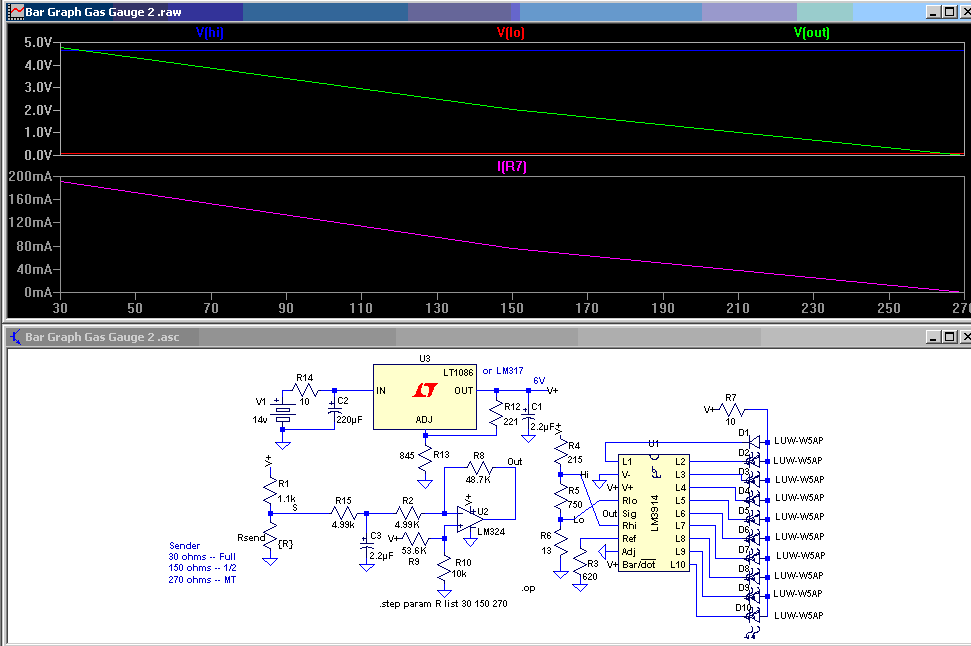

i would like to make a 10bar led display for it as i have no room for a gauge.
I have been reading a little about the lm3914n controller to a 10bar led. (i have purchased both)
i now need to know how to hook this up if someone could assist me (the boat is using a standard 12v deep cycle battery)

it now ready 243ohm empty
That would do it. I at least knew what half-full and half-empty were. :D
So, it makes things a bit more complicated. You need to invert and offset as well.
It would have been easier if you had a sensor that went the other way 30 (empty) to 240 full.

I think this can be done without opamp and voltage reference . LM3914 has a voltage reference.
It's output and offset can be programmed with a few resistors.
If the fuel sender is the upper part of a voltage divider the voltage from the divider will move in the right direction.
You need a voltage regulator, maybe 8V, to which the voltage divider will be connected.

Can you confirm that both the pink and black wires of the sender are (or can be) electrically isolated from any metal-work (sender body or tank)? This would be necessary to adopt the approach suggested by Jjw.
For safety you will need a high value resistor in series with the sender and measuring circuit, also you might need to look at the reference voltage supply to the sender too, if theres a short you do not want a spark, or glowing resistor track.
You might also find the sender isnt linear, take some resistance measurements with the float in 10 equal positions from empty to full, to see if they are linear, or at least give you some idea of the non linearity.
Below is a circuit using the LM3914 with the sensor grounded. This circuit assumes the resistance changes fairly linearly from empty to full. An op amp is used to invert and scale the signal so that minimum resistance (tank full) gives maximum voltage to the LM3914.
R8 and R9 may need to be adjusted for the full scale and offset voltage going to the LM3914 input to give the desired readout.
R3 determines the LED current which is about 20mA for the 620 ohm value shown.

thanks for all your replies,
I have checked the continuity and neither are connected to the metal mount.
