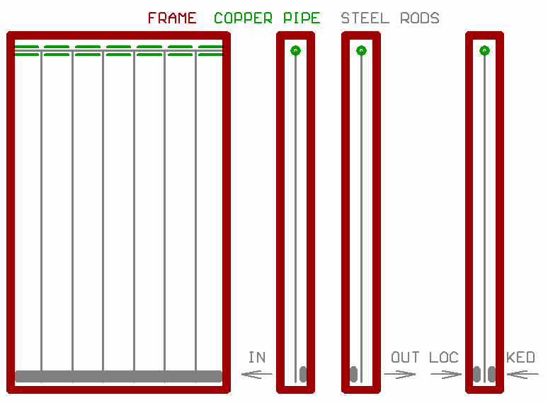

a sliding door will more or less mean the sure death of a late chicken. (Some of them don't return home before dark.)
Here is a way to ensure all chicken get home safely.
Use bicycle spokes for steel rods and have them hang down spaced evenly. Push or slide two steel bars up or sideways to block either opening direction or both.
For details see attachment.

Sorry, it probably does mean that, I'm not great on the terminology yet. What I'm talking about is a little door much like a cat flap into the chicken coop to allow only the chickens access.
Thanks Boncuk, that's certainly another way of looking at it, one question however
If you mean the guillotinesque action of the sliding door, I would plan on having it shutting as slowly as possible and perhaps even retracting if it meets any resistance before closing entirely.
I do still like your idea but what type of device would I use to slide these bars?
They are not sliding bars, they are individually hinged at the top.

If it's like a cat flap, you might look at using a windshield wiper motor. You can get them at any junkyard cheap, are strong enough to open a small door, only need to be driven in one direction, and have a limit detector switch built in them that could be used to stop it in the closed position.
I meant the chicken staying outside the house will fall victim to a fox.
The easiest way to move the slide bars - the vertical ones are hinged and move freely - is a motor with a cam pushing the bar up, releasing it when the cam is moved to the parking position which then lowers by gravity force.
