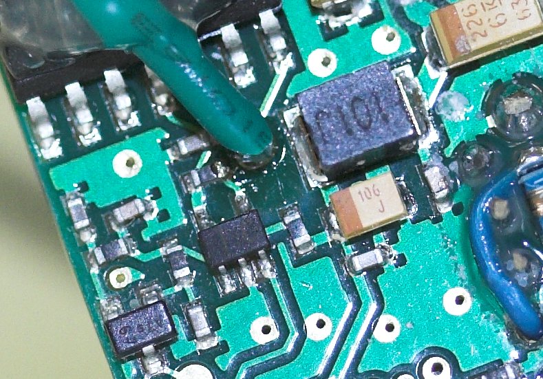

Maybe back when dinosaurs roamed the Earth when you were using them they were unreliable, but today they are very reliable. No less than five times have I taken apart a device certified for use in life support applications to find them littered with tantalums. I used them in college for statistics experiments to verify the claimed reliability of the manufacturers only to find every single time that it was right. Trials were conducted over several months with varying as well as extreme temperature and voltage gradients.
I even attached a picture of an RC receiver using tantalums. This module has been in service for several years in the bitter cold and blistering heat. I'd say it was a fluke if I knew as little about tantalums as you seem to but the reality is that they are better devices than their aluminum electrolytic counterparts in many applications. Your inability to get past your ego is quite irritating when all of the facts point the other direction from your opinion. That is not how science works.
