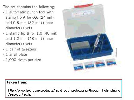

We call these 'eyelets'
We consider rivets to be a fixing like nails or screws.
These are similar to the metal bits that shoelaces
pass through on shoes.
The ones illustrated are probably brass,
its difficult to tell.

I was thinking about the real thing, not the ilets.
Read about it about 13 years ago, drill a blank pc board and using some technique to stick a thin layer of copper on the board, than each it.......
I need some details, what is the chemical, how to make it/get it, how is happening step by step.. :idea:
