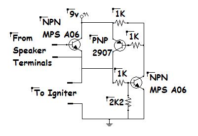

ok, here is the latching schematic i'm using (from Exo):
-this is for model rocketry, so the igniter is a peice of nichrome with some bp on the end (made 'em myself so there is a lot of bp on the end)
-the idea behind this is that i want the thing to ignite when the timer starts to beep, and because it beeps (high low high low) i need a latching circuit to change that into a steady high current which can ignite the igniter. but because i can only have one 9v i need the 9v to power the latching circuit and ignite the igniter. but the transistors take too much away from the current so it can't ignite the igniter just by hooking the igniter where the res. and led are (res. and led are taken out). and the 9v does, alone, have enough current to ignite the igniter.
-i'm tring to fit this all into a altoids container, which is say 4 by 2 inches. the timer and 9v leave only about a 1/2" by 2" for this circuit. i think i can fit it in that area but i need it to work first. (please don't just give up because of the small size, let me be the judge of size and how it will fit in, i can always change things)
the latching circuit is triggered by a the pluses from the timer's speaker, all i need now is to get it send all of the 9v to the igniter so it can ignite the igniter.
igniter is in place of led and R1, all other res values are 1K, but the res with the red arrow next to it is 2K2.
Only the PNP is between the power source and your ignitor, so there will only be a 0.6V drop leaving you 8.4V, I can hardly believe this causes it to fail...
How much current does your ignitor require and what transistors are you using (type numbers)?
and can you draw how you connect the buzzer to the circuit?
The igniter goes off fine with a 'ok' 9v, meaning the 9v is not new but is also not at all dead. I'm sorry but i don't know the exact voltage. The only theory i can come up with is that the PNP also takes away a lot of the amps from the 9v, causing it still to retain its voltage but not causing the resistance needed in the nichrome to generate any heat. One thing that is a little weird is that when i tried to test this circuit (with the igniter) the latching seamed to turn off because of the short in the circuit (by the igniter), this even happend when i used a different powersource for the circuit and just used a transistor, in place of the LED&res, to switch a 9v to igniter only circuit on. Its almost like full 9v current through a transistor turns the transistor off for a time.
anyway, here is the circuit with the 9v power supply that i modified from the previous circuit:

I wouldn't use a emitter follower for this, but you can always try it...
But it needs to be connected diffirent, as it is now you're just shorting the speaker output out. 1 of the speaker outputs should go to gnd.
You say the latch turned of when you tried it with the ignition. There can be many reasons for this. Maybe your power supply can't supply enough current and goes 'trough its knees', making the voltage drop below the voltage required to keep the transistors on. Maybe the ignition requires more current then the PNP you use can handle...
Knowing the current required for the ignition would realy help.

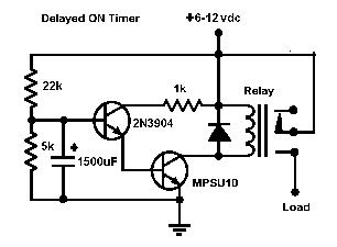

Will a timer circuit work for you? This is a timer that will wirk on 9v fine. It will trigger the igniter. Just put the Igniter in place of the relay.
I already have the timer, all i need is a simple circuit to ignite the igniter when the timer starts to beep. And i really don't want to give the timer up, it can go up to 99:99 and is accurate and programmable to the second :D
the only problem is it beeps at the end, which complicates things for igniting stuff.

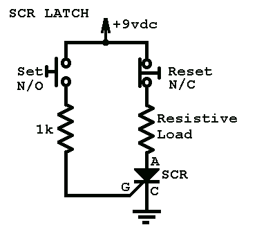

Here is a simple SCR Latch circuit.
thats....exactly what i want to do....and its simple! THANKS HWW

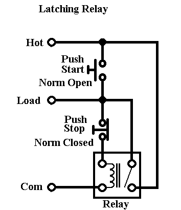

now...this idea of a "latching relay" interests me...how exactly do you go about modifying a regular one to become latching. i think i know how but i just want to be sure... but the button 1.5v can't fip the relay...so a transistor arangment should do that... i need to do more testing
