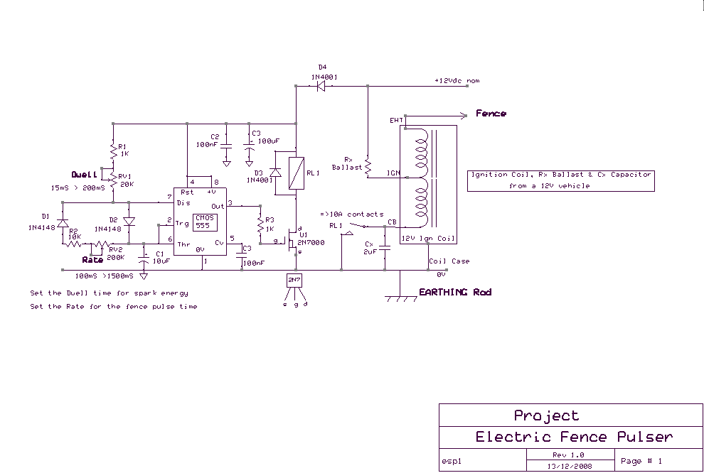

Hi Nigel, could it be from Eric Gibbs in his post (February 23, 2015) #8 in this thread: https://www.electro-tech-online.com/threads/solar-electric-fence.143863/ ?
I attached his schematic below; he uses a relay to periodically discharge the main capacitor and create a high-voltage spike.

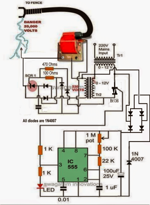

In a second attachment another circuit is shown, but here an SCR is triggered to discharge the main capacitor.
What are your feasibility comments on either circuit? Or any better ideas or improvements?

Beware that the energy level from an ignition coil can be dangerous, fencers can be as high a voltage, but limited energy.

It's unlikely that a typical ignition coil circuit could generate enough energy to be dangerous to humans (of course the shock can hurt like heck).
It's got to be fairly strong, or it wouldn't discourage cattle etc. - but because it's pulsed it's not dangerous to humans either - the energy available is relatively low.

The "On Time" of typical flyback or capacitive discharge is always a very short spark.
It's not possible to appreciably increase the spark of these circuits' on-time to make it dangerous.
If you want a lower output voltage from an automotive coil to avoid insulator problems, but with a higher output current, you can use a capacitive-discharge circuit with about a 100V capacitor charge voltage and a larger charging capacitor.
