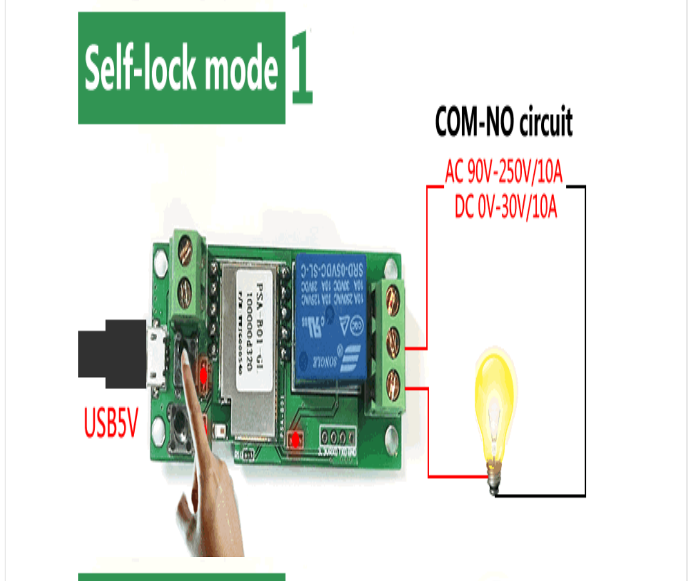

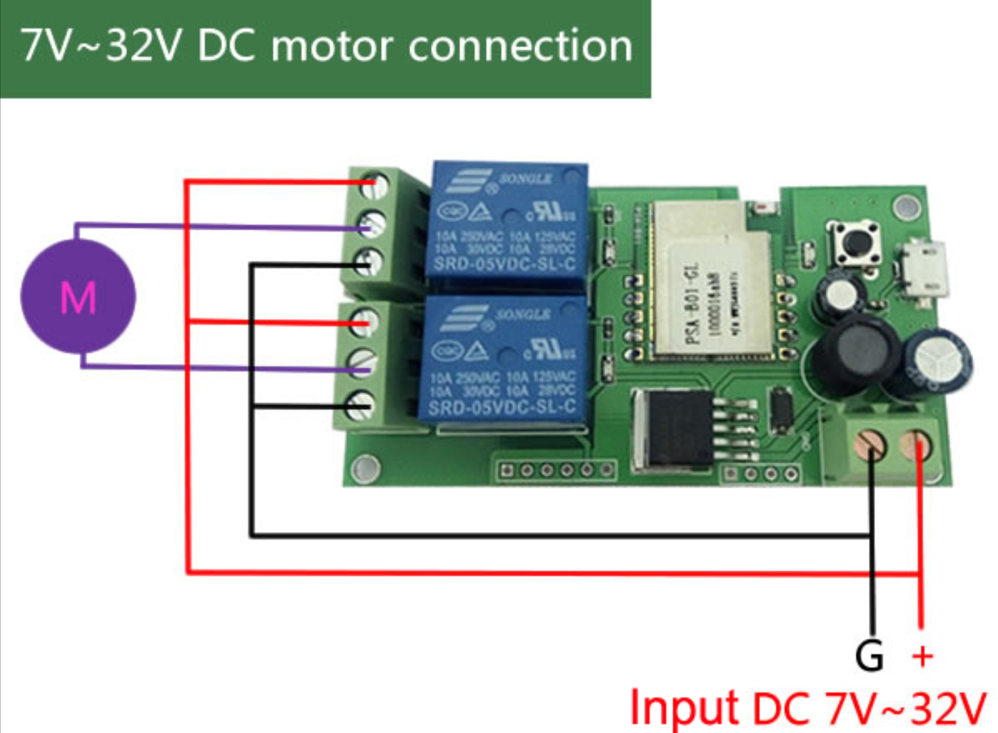

How about a cheap solution that's controlled by a smart phone app? Not exactly what you asked for, but a workable solution that you can have working in short order without too much trouble.
iTead Studios in China has an impressive line of smart home remote control modules. For about $6, you can control a lamp or appliance from around the world with your smart phone....or from in your house with a phone or tablet. I have about a dozen of these in my house controlling lamps and they are awesome. The amazing part is that for the price some companies want to control one lamp, I can control my house.
To control draperies, you'd need two modules. The first is a motor reversing module. This is usually called an H-bridge, and it controls the direction a DC motor turns by swapping the polarity of the power connections. This module can only control the direction the motor turns. It can't turn the motor on/off.
To turn the motor on/off, another module is needed, a inching, self-locking module. Translating that name into something that makes sense, this module is an on/off switch. This module would feed DC power to the motor direction control module to run the motor.
Check out the links to see if these modules would make sense for your project.

Jonsea 1st pic is a great little device, never noticed it runs on wi-fi! May be the easiest... might be easy to program with too... depending on how it accepts instructions..

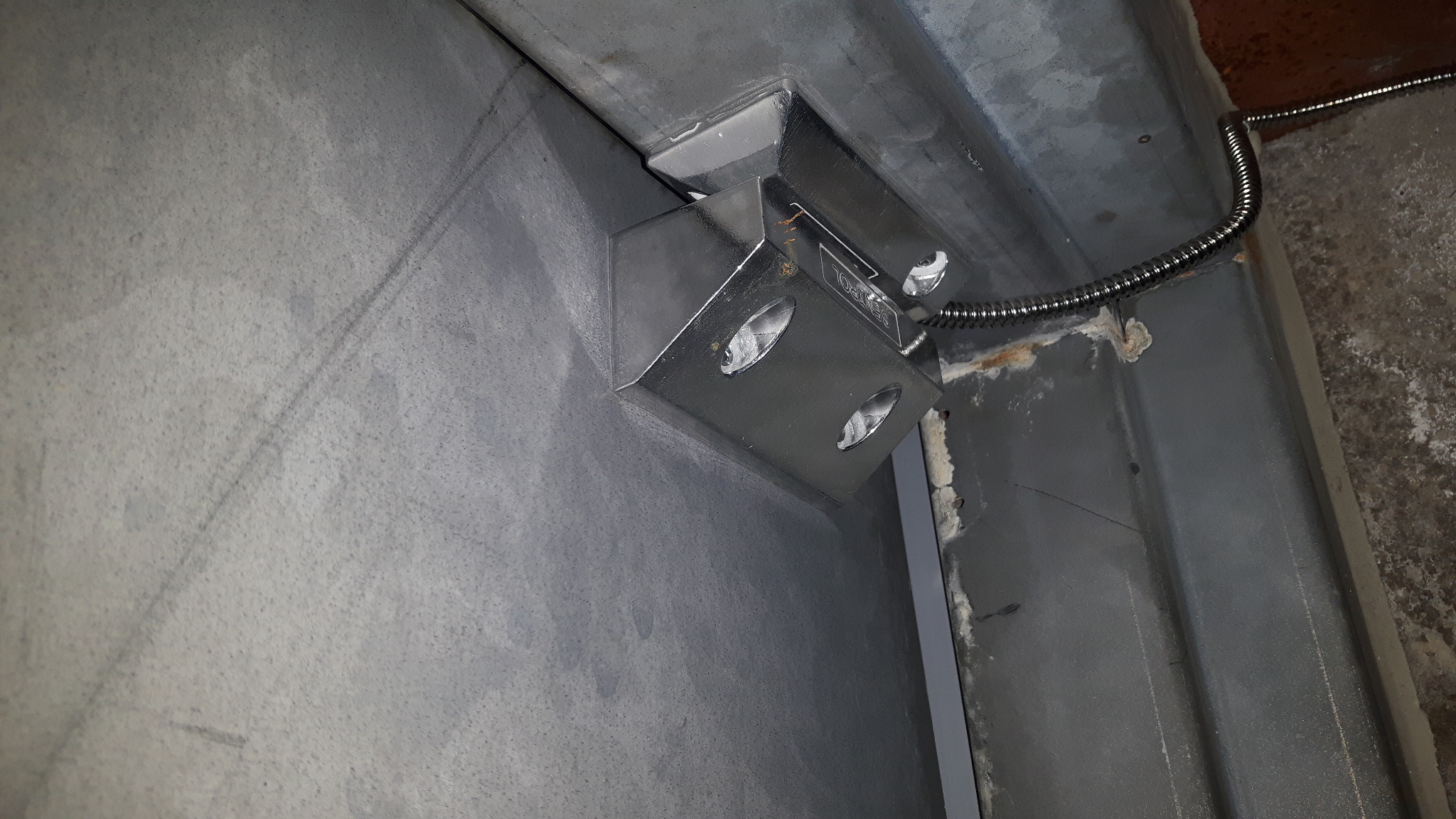

ya, typically.. we needed an industrial sensor when our door warped 2 full cm20161122_145231.jpg
