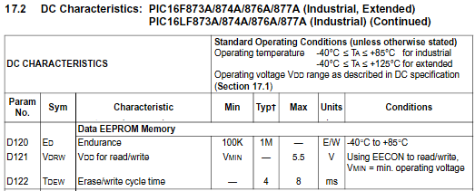

I'm trying to find the maximum time a write to EEPROM could take. I've checked the datasheets and searched the Microchip website to no avail.
I have written some code to measure the time and for a 16F876A it appears to be 4.5mS. This only allows about 200 writes per second which seems very slow. It appears to be independent of clock speed.

Your measurement is well on the spot. The specific EEPROM location needs to be erased first before written to so that would account for the relatively long timing.
The actual timing data is hidden inside the DC characteristic of the datasheet. The timing seems to be independent of the MCU clock speed but I remembered some "overclockers" mentioned data error with EEPROM write at 24MHz or higher clock speed on a 20MHz PIC.

Thanks, I missed that in the datasheet.
Looks like I will have to drop down to 4800 baud as the worst case is 8mS. :mad:
