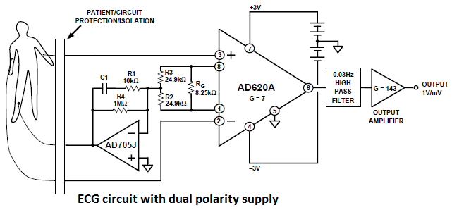

1) So what would be the best filter topology to use to filter out the 50Hz mains the body picks up?
If I start there I can then look at the other swamping frequencies and deal with them. But before I try and look at amplifying other signals from the body I am interested in the filter of unwanted signals. I have read up on filters but I cant work out the best starting Topology to get rid of the 50Hz first.

You should be using an instrumentation amplifier with differential input; otherwise, with a single-ended amplifier you'll pick up so much mains interference no amount of filtering will yield a clean signal.
To see how, check out Figure 109 on page 67 of this appnote by Linear Technology.
For the mains frequency you can use a notch filter which has a deep signal rejection notch at the design frequency.
An ECG device uses shielded cables to the probes. Then instead of grounding the patient they feed him out-of-phase common mode interference to his right leg to cancel interference he picks up.

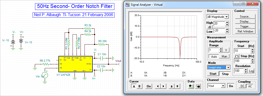

A "tight" notch filter can be a pain to construct from normally available parts.
TI makes an IC specifically designed for this function (others as well):
A -20dB reduction might not be deep enough for you. I'm pretty sure you could cascade additional, similar circuits.
UAF42 info.

The classic twin-T (or bridged-T) notch filter can be a royal PITA to set up because it requires three precision resistors and three precision capacitors; to get good notch depth they must all be precisely matched, and to tune the filter the three resistors all have be adjusted in unison while maintaining the exact ratio between them.
There are other notch filter topologies you might look into:
The Wien bridge notch filter
The Fliege notch filter
The bridged-differentiator notch filter, which is very easy to tune, and
An interesting notch filter I can't find a name for (see 1st diagram on page).
The Q of the bridged-differentiator notch filter can be increased by buffering its output with a unity-gain follower, and connecting the junction of Ra and Rb to the follower's output instead of to ground.
One caution about notch filters: a 50 Hz notch filter will ONLY remove the 50 Hz fundamental frequency, leaving its harmonics, and all other high-frequency noise, unaffected.

Yes but later on I want to be able to pick frequencies and hammer those specific ones. A notch would give me the advantage of tight control, while this is 50Hz at the moment, some of the frequencies later on will be fairly close to each other.

Thanks for the links, Would make sense to have a go and build some. I also like AG's idea of the cancelling via the leg, as its for nerves etc that might be a good option.

The circuits with the right leg cancellation of interference do not show a notch or lowpass filter, maybe because it is not needed.

So first step try the circuit shown for ECG, from there I can start looking at what I am really after, my assumption being the cancelling part should work for most signals I am after?

The cancelling circuit cancels all signals picked up by both inputs of the instrumentation amplifier at the same time including some DC from breathing.
So it will work for the heart, but not for some nerves. Or put a better way I can only go after one frequency at a time. Not a problem for now, I want to get the first bit done. Then I will worry about the other parts. Apart from the heart most of the other frequencies I am likely to get hold of are all under 40Hz. Unless I take a scalpel to someone.... ANY Volunteers??
