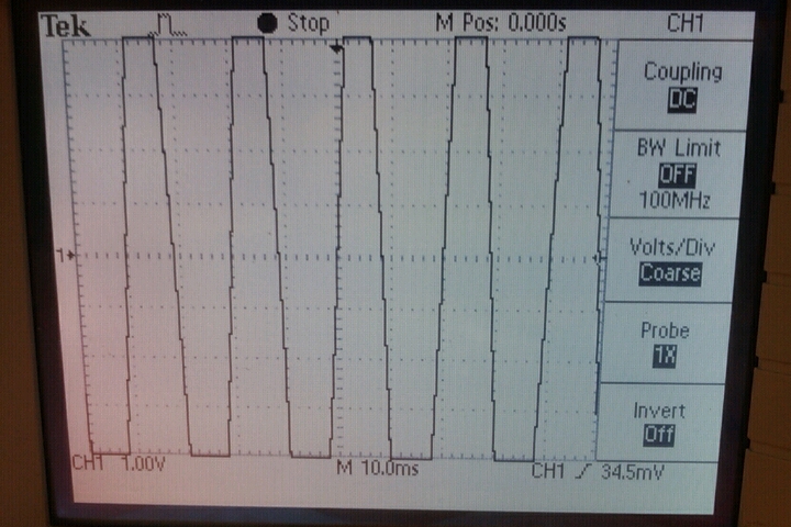

I have built a ECG device with AD620. The circuit was shown in ECG circuit.JPG attached.
However, the output of AD620 was not as expected. I took a picture of it and it was attached as well.
Can somebody help explaining why the output is like this?

That is approximately 50 Hz (maybe 60 Hz) pickup of background noise from the mains. Increase your attenuation and you will see the full wave.
John
You are just seeing the background noise, which you are picking up from the leads, grounds, and maybe your power supply. If you are connected to a person, that person is just an antenna for all of that background.
Heart rate is approximately 1Hz by comparison. Your scan width is way too narrow at this point. Later you can trigger on the EKG QRS complex, but first you have to find the pulse. Try something that will capture a 1 Hz signal. It appears you are set on 10 mS per division. Go to 500 mS per division. You also need to get the peaks on scale for your oscilloscope.

I have changed the Rg from 6.98K to 30K to reduce the gain, but I could still only see the noise. Will there be any problem with the two 22K resistors? Should I adjust the value as well?
I think I have misunderstood attenuation.
Higher the gain gives greater CMRR and also the attenuation (please tell me if I am wrong), so I should increase the gain for better noise reduction.
But it showed no improvement at all when I changed the gain from 8 to 990, still only noise was observed.
Please advise how to remove the unwanted noise. Thank you so much.
I think you should use shielded (screened) input cables so that they don't pickup mains hum.
You also need proper skin contacts that have conductive grease.

I used shielded cables and connected the shield to system ground. However, still only noise was observed.
Which part in my circuit went wrong?:confused:
I found out that there was a 5V DC offset in the AD620 output. Can somebody suggest how to remove the DC offset?
An AD620 with low gain has a very low offset voltage. The right leg driver cancels most common-mode hum pickup and any DC offset.
I think you probably have an input that is not connected to the patient.
When I had an ECG, the nurse shaved spots on my chest and "scratched" the skin. Conductive grease was used under the probes.
