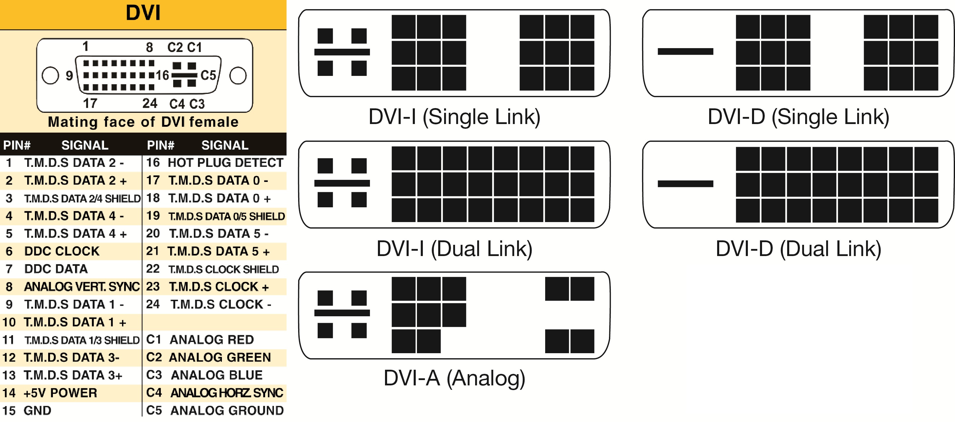

Hi guys,
I have an industrial PC to be repaired which seems to have problems at DVI port. If I don´t connect anything on it and I measure with the scope should I have signals? if so, which ones?
Thanks, regards.
C4- Analog Horz Sync should have a signal.
8 Analog Vert. Sync also.
14 +5V power.
6,7 should have a resistor pulling them up to 3.3V or 5V.
BUT!!
Windows is complicated. The PC should send +5V to the monitor. Then the PC will talk to the monitor over pins 6, 7. At that point the PC will know what type of monitor and what resolution. (only then can the PC know what H. and V. sync frequency the monitor can use)
There is a good chance the PC might not send any video signals until all this works.
All the TMDS signals have a very small signal when working. So only the H and V Syncs will have something you can see simply. The DDC clock and Data are TTL type but will probably not have data if there is no monitor.
OK, understood, thanks. I´ve seen a chip https://www.amazingic.com/chinese/01_products/AZC209-07P near the connector. First I´ll scope outputs directly at connector and then I will go deeper in the chip. I don´t know which operating system is using this unit. Monitor connected was Hatteland and also with problems so I don´t know which damaged the other...
If the monitor is not taking back to the video card after the video card sends the 5v communication signal, the card will not try to send a video signal.
OK, understood, thanks. I´ve seen a chip http://www.amazingic.com/chinese/01_products/AZC209-07P near the connector. First I´ll scope outputs directly at connector and then I will go deeper in the chip. I don´t know which operating system is using this unit. Monitor connected was Hatteland and also with problems so I don´t know which damaged the other...
that chip is an ESD protection device. check to see that none of the signal pins on it are shorted to ground or Vcc. there are 3 VCC pins, and one GND pin.
