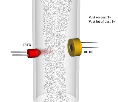

how can it detect a dust?
I have an idea. See image.
When there is heavy dust, the air suctioned through the vacuum tube will be cloudy, hence IRTX light will produce less voltage at IRdetect.
As Dust is removed, more IRTX light will be detected.
What do ya think?

the way Mikebits point out would also be my aproach but still a lot of tweaking involved to get something sensible working
in my opinion its easyer and probably cheaper to avoid getting dust in the first place
both solutions you need a fan and the control of a over pressurized room is far simpler to achieve

I've just been doing a bit of googling on dust detectors. I think your general idea is more or less what many systems are based on. Then again, almost everything I've found so far is for use in engines, spacecraft, or reactors.

On the floor directly under the robot? Then perhaps the link I posted on your other thread will help: it's for detecting dust on a surface beneath the sensor. It should be possible to modify for your uses, depending on the kind of surface you'll be on and what amount of dust you want to detect.
It's more or less the same idea that Mike posted, but instead of detecting the dust in a tube it does it by bouncing the light off the floor and seeing how much is reflected. More light reflected means less dust.

to detect dust on the floor the best way is to have a light beam send in a sertain angle and picked up by the IR TX sensor
if there is dust there will be no reflection or in a different angle and out shouting the sensor
the sensor should be put fairly close to the ground the beam must be very narrow also
still you will have funny results as colors and no level surfaces
so there are quite some conditions that have to be right in order to make it work

whoaaa..yes!!!thats it..will detect directly under the robot..i will try to build the circuit..thanks
