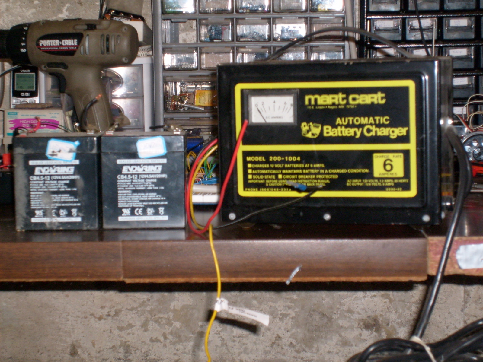

I have an automatic 12v lead acid battery charger (it came off of one of those carts you see old folks riding around in in Walmart) It says it can charge Lead Acid batteries at 6A.
I also have 2 small lead acid batteries (12 volts a piece, 4.5A/hours for 20 hours). Can i use that 6A battery charger to charge them? Will the "auto charge/maintain" function on the charger work? Or will the charger force too much current through the batteries and damage them? What about charging them in parallel? Or is that just plain stupid?
Also, the charger has 3 wires coming out of it? They are Red, Yellow, and Black... What do they do? I know that Yellow is + and black is ground, but what is the red? I will take some pictures if that will help... Actually i know it would be a good idea... I will post this then run down to the basement and take a picture quick...
Thanks.
Ok. Here is a picture of the charger and of the 2 batteries. The charger charges at 12.6v
Also, the little tag on the yellow wire says something to the effect of "+12 Relay Only", so i am assuming the red wire is the charging wire? what would be the purpose of the relay? turn charging on and off? Switch batteries? (the people cart the charger came from had 2 12 volt batteries in a series for the 24 volt motor, so maybe the relay chose what battery to charge?)

A few months ago, I was asked to get a 36 volt golf cart charger working. Kind of an oldie, but found the owner's manual online, and included the schematic. The relay switched on the charger when plugged into the cart. The batteries needed some charge to start, wouldn't do complete dead batteries. Yours is likely to be similar. Search for your charger, manufacturer usually has owner's manuals online.
I probably have the files still on my computer, but not likely to be a huge help, very simple design.

Those batterys appear to be a 4.5 A/H Rating, Base on a 20 Hour Discharge rate.
(About 0.225 Amps continuous output for 20 hours.)
NOT 4.5 Amps for 20 Hours.
The Charging current should be about 450 mA, maybe a bit higher to start, than tapering off.
But 6 Amps is way to high.

I wouldn't use that charger if you want to maintain those small batteries in good shape; Walmart has a Schumacher charger for under $19 that charges at two rates, 2A at 14.5V initially until the charge rate tapers off under 500mA, and then switches to float charge at 13.2V, which can be left on indefinitely for maintenance.
Works really well for motorcycle batteries and the like-
