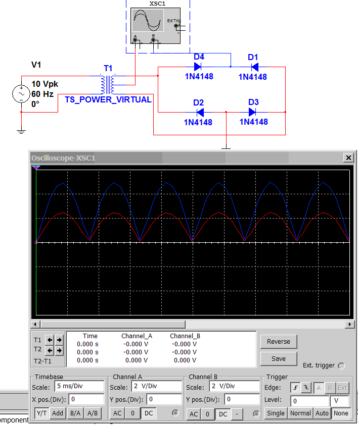

Hmmm sorry, I seem to have a hard time simulating AC circuits. I'm surprised that what I did didn't work as the input potential to each bridge indicated it would but I suppose a oscope would have indicated otherwise. If I understand your post correctly, below is what should work?
Lo and Behold! That DOES work! (according to simulations). Interesting that both waveforms appeared sinusoidal and did not appear like a regular rectified waveform dipping to 0. Maybe I messed something up in simulations. If this was correct this circuit would require much less smoothing.
Luckily this will only require one jumper to fix on my PCB. Thanks tons crutschow!

The reason your circuit doesn't work is because you would need an isolated ground for each bridge output. There is interaction between the two bridges when you try to use a common ground which causes what you observed.
With no filter caps, both outputs should look like a full-wave rectified sine wave. With filters the outputs should be DC.
Edit: Here's a sim of the circuit with no filters.
