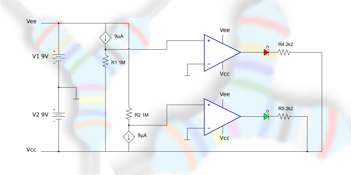

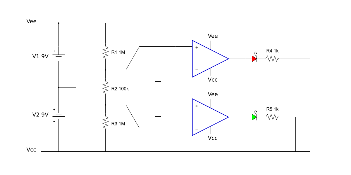

btw - an easy way to get an battery voltage drop indication where it's supposed both batteries in series should have equal voltage over the poles:
The resistor values is just a starting point - OP may need to increase R2 if it's too sensible to voltage drop of either batteries. Also don't care about values R4 R5, they need to increase to match supply voltage of ~18V.
Red led: V2 < V1, green led: V2>V1.
At least that is intension - error may occur as it get late.

Another possibility of course is to use a constant current source and series of resistors - should be possible to solve in a similar way using two opamps.
[edit]
something like that - except current source must be adjusted to below 9μA, or resistor adjustet slightly down - you get the picture.

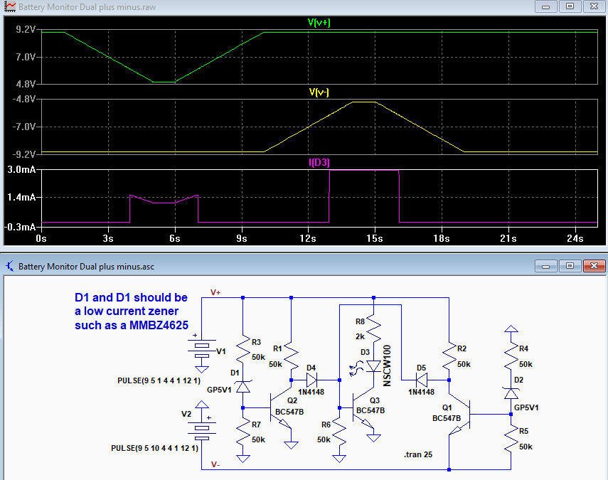

Here's the LTspice simulation of a simple circuit that will turn on the LED D3 if either voltage drops below about 6V.
The threshold is determined by the value of zeners D1 and D2.
The LED should be a high brightness type to minimize its required current for good visibility.

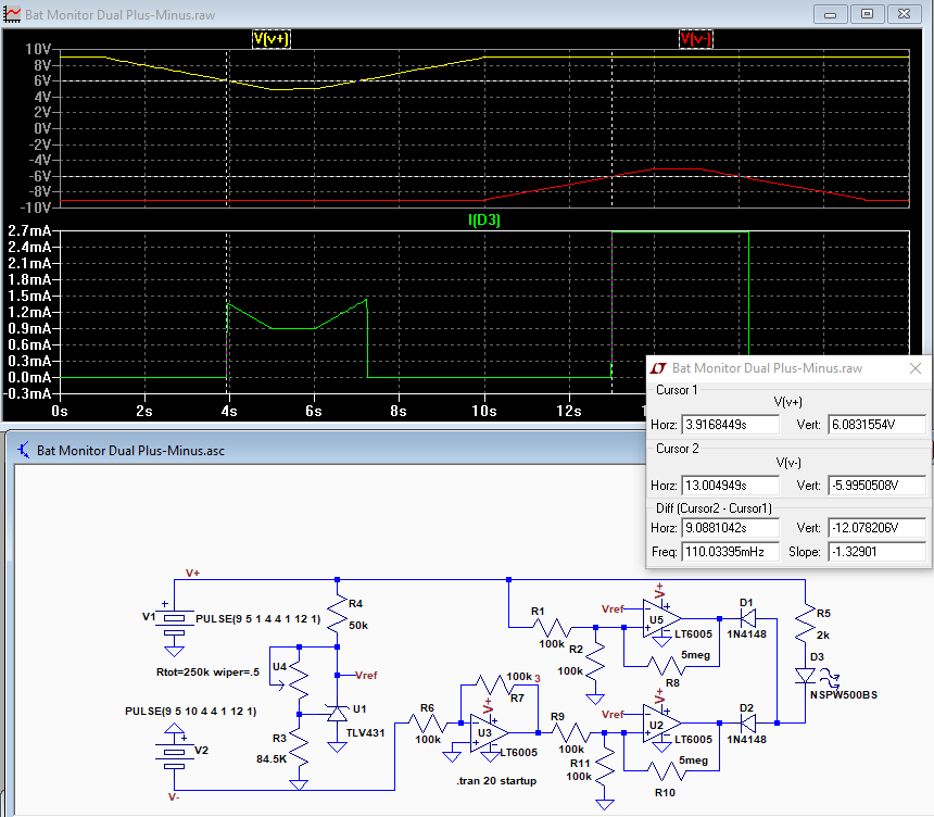

Here's a somewhat more complex circuit using a quad package micropower opamp that provides a very stable trip point as determined by reference U1.
The trip point can be adjusted with pot U4 (shown adjusted for a trip point of ±6V).
