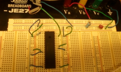

I've finally attached a picture of the setup. The setup is the only thing I can think that may be wrong right now. As you can see it is very simple. It is nothing but the 3 VDD and 3 VSS connections. And an oscilloscope on some pin. That and I pulled MCLR (pin 1), up to 5V using a 5K resistor as my professor said I should. Is there something missing that might explain the lack of chip response? The new chips are in, but I don't want to write to them to see no response if there is a problem on the board.
Thanks again.

Things look like they are hooked up O.K. Hard to tell from the picture, but presumably the green wire on the left side of the chip is hooked from the vertical positive rail to the horizontal positive rail of the breadboard. Double check that 5V is getting to the chip.
You are showing the breadboard without the programmer hookup? Again which programmer?, has it been successfully used on other chips? Make sure the programmer doesn't have the device in reset box ticked, that would keep the chip from running the program. Check to make sure that hex has been downloaded in the program view box when a device read operation is performed.
Otherwise, where is the programmer hookup? The programmer is needed to install the compiled hex code from MPLAB to the chip. Should have picked up a Pickit 2 programmer while you were at it? Attached is my setup for the dspic30f1010. From top to bottom the Pickit 2 hookup is MCLR, Vdd, Gnd, PGD, PGC.
I also hooked up the analog AVdd and AVss pins to the Vdd and Vss pins as a precaution. Shown is an led on the RD0 pin to show a successful outcome after programming the blinky. Having the 0.1uf cap close to the microcontroller supply pins is always a good idea.
Is the power supply regulated at 5V? If it is a variable supply, then you are living dangerously without a lm7805 regulator ic. Accidently overvolting, or shorting Vdd to Vss can kill a PIC.
For my dsPic30f1010 the osc needs the PLL enabled in config for the Analog and Pwm modules to work. Not sure if that applies to the dsPic 30f4011, could be yet another oddity of the 30f1010.
Then it's time to try the old chip again, no luck?, then try a new one.
