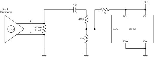

Hi
I put together a quick diagram per your description.
Can you check?
thanks
eT
Connect all the Vcc(s) together with out resistor.
Move resistor , ADC in --Resistor---Vcc.
The way you have it the ADC will only see the positive half of the signal.

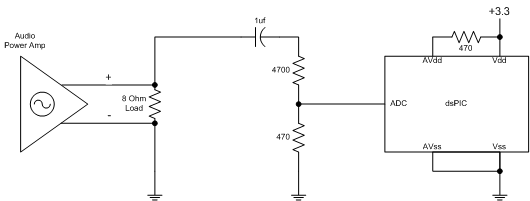

Ron..
Is this what you mean?
eT
You can change your divide ratio by changing the 4700 resistor.
Because you said dsPIC I think you know to sample fast.

Can you share with me how you came up with those values?
thanks.
eT
You said you wanted the impedance on the ADC input to be 200 ohms. (I think 1k or maybe 10k is ok)
So; 470 parallel with 470 parallel with 4700 is about the 200 ohms you asked for.
The output of a power amplifier is much larger than 3.3 volts so it must be divided down.
4700 ohms to the signal and 235 ohms makes a divider. The two 470 resistors look like a 235 ohm resistor to 1.65 volts or (3.3/2).
I doubled checked the data sheet for a dsPIC33FJ128GP802, and it says 200 ohms....does seem kinda low though.
I just wanted to see how you came up with those values for my own benefit.. :-)
Regarding the 4700 ohm resistor, I need to adjust that based on the anticipated AC input, for different scaling levels.. right?
To keep the AC input voltage at 3.3v p-p max....correct?
eT
I cant find 200 ohms in the data sheet. Probably in a application note.
Yes you can change the 4700 resistor to get 3.3V p-p max.
You could measure the power supply in the power amp and divide down for a first start in resistor value. (+/-30V) or (60v)--->3.3V
